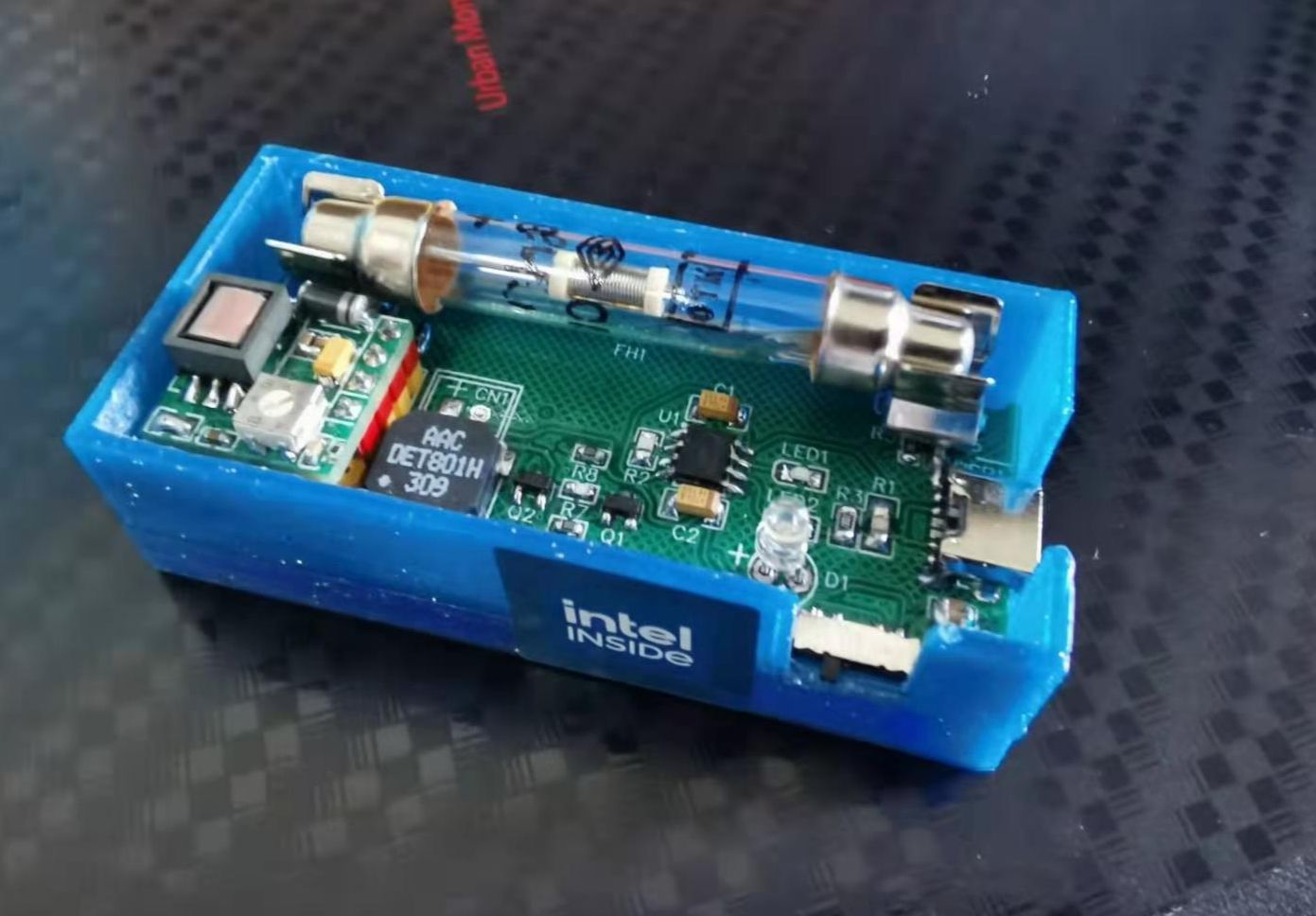

The 15*15 small booster board used for the power module is already very complete. The base plate has type C input charging and is installed with a 6mm fuse holder. Currently, the output LED flashes and the buzzer sound is small.
Pipe parameters:
Dose range: 300R/h Large dose tube, low sensitivity
Working voltage: 380-460V Generally used 400V
Working current: 0.015-0.02 mA
flat? Length/Slope: 80V/0.25%/V
γ Sensitivity: 188 – 235 Pulses/s/R/h
Background: 0,2 Pulses/s
Operating Temperature Range: -50 to +60 СLength
: 55mm
Diameter: 10mm
See attachment for shell file
