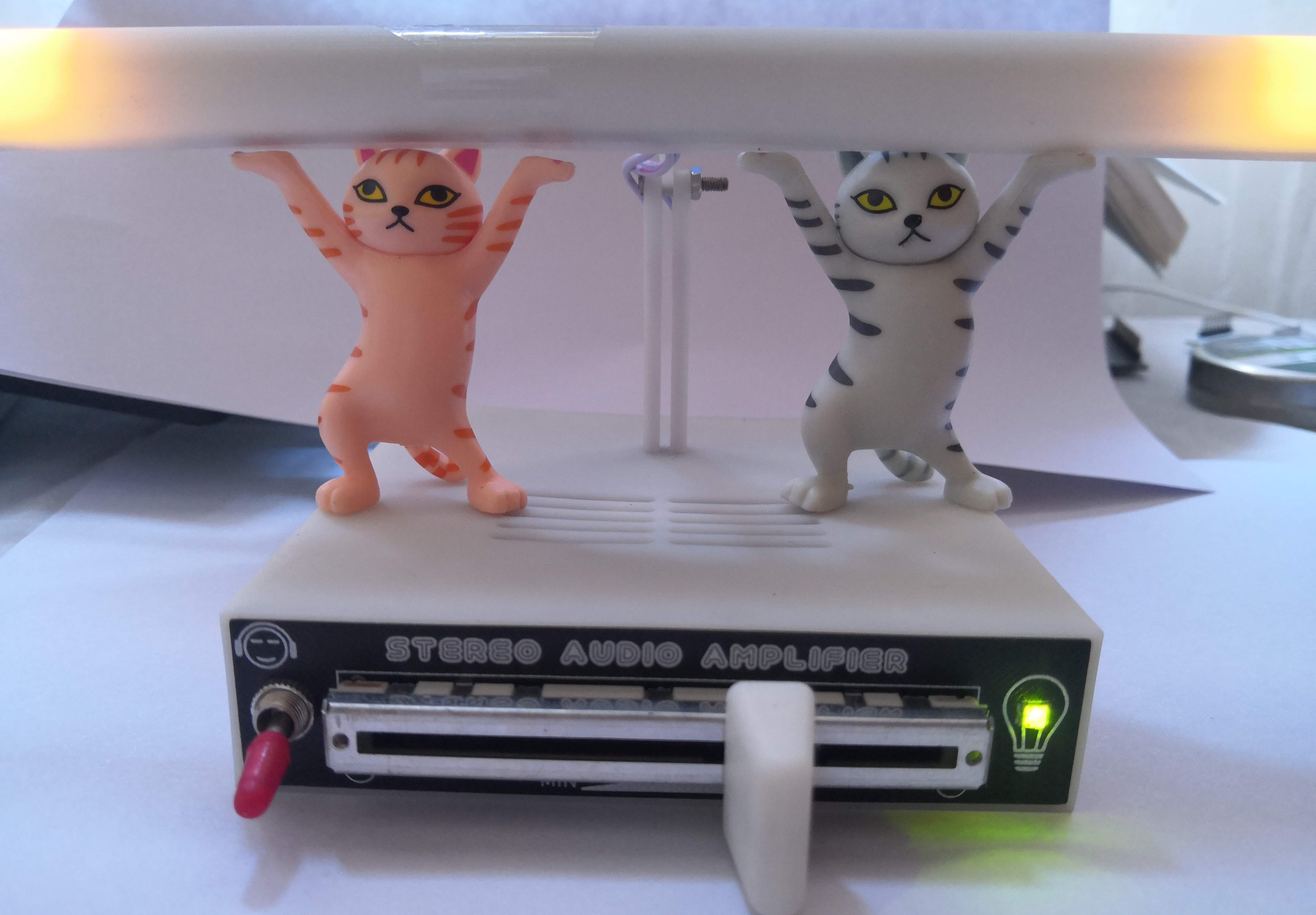

Both the front and rear panels are designed with PCB, which is mainly cool (JianDan) and the cost is also very low. The front panel is mainly equipped with faders to adjust the volume, LEDs to display the working status, and switches to control circuit switches. It is connected to the power amplifier board through a cable. Below is a picture of the finished product. I personally feel it is pretty good hahaha O(∩_∩)O

In addition: How can an exposed circuit board be used as a mature product? Engineering people also have aesthetics (shivering...), so I also designed a casing for this product (the modeling technology is really poor, As long as it can be used, it’s good if it can be used (^o^)/~).
Designed using Fusion360
1L3D1p7N8mvExGV6K5yks111MFZUSzHdS78ML8yc.pngr9Uk2XQXyHTPeSfHC0IIW1P7f5LlkI3t3zdkFzDD.pnghytL4foL0uHYYomOxkacleJ1EvBhzLd4BAN1iyTc.png
You need to calculate the dimensions when designing the casing. It would be embarrassing if you find out after 3D printing that it cannot be installed...
Problems encountered
With Liu Gong's blessing, the board basically has no problems, works normally, and the required effects are achieved. But what needs to be paid attention to is the power of the speaker. When outputting high power, you must use thicker wires, otherwise the wires will be seriously heated,,,,, and then there will be no sound. . . .
Attachment: In order to enjoy the coolness brought by music in the hot summer, I installed a 12V cooling fan in the final version to enhance heat dissipation.

Actual before and after photos:
Supplement: The audio output interface and power input interface at the rear end both use DC005 round plugs. However, in order to avoid incorrect insertion, the audio output interface uses a 2.5mm wheelbase, while the power input interface uses a 2.1mm wheelbase, so the power input terminal cannot be inserted. to the audio output port to avoid damage to the power amplifier caused by incorrect insertion to a certain extent.
cSg7oYbinAO0gEkanGICxZHryOeDZq4hvLOuzHOf.png8Pa8QK0n0Ly66RCwNF9Ou4aUZTAfiquVkhxOy5kE.png
