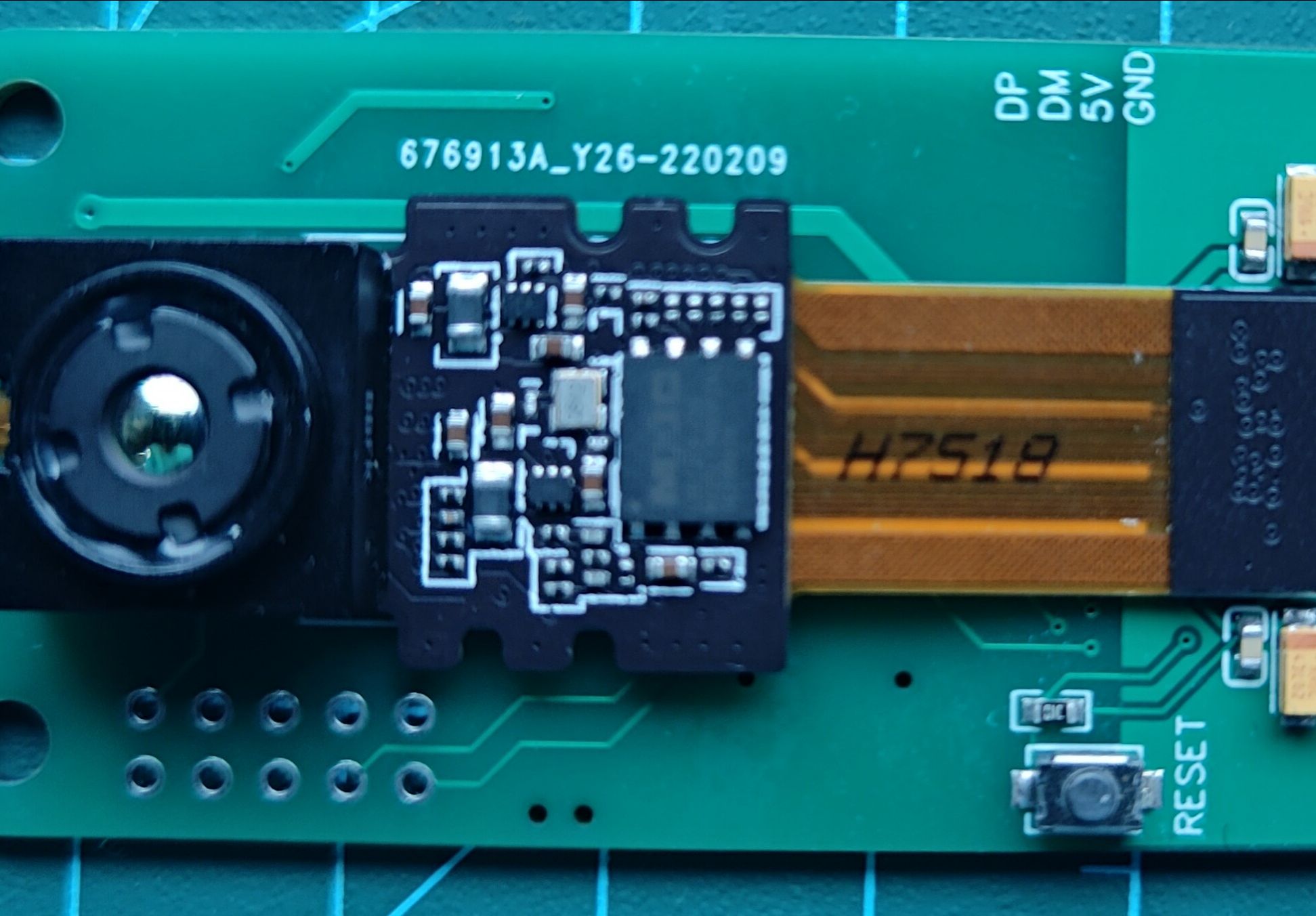

The main cost of this project is the thermal imaging module, and the purchase channel is quite special. It is not available on general e-commerce platforms. You need to contact Arrow Optoelectronics
for product consultation, or contact a dealer with whom it has a cooperative relationship to purchase.
Arrow official: https://www.iraytek.com/Thermal
imaging module Tiny1-B information link: https://www.iraytek.com/product/jxmzpro-detail-119.htm
Its thermal imaging module If interested, please contact WeChat: xgy1224122078
Currently, the only supported usage platform is PC host computer, and Linux and Android platforms are still under development. Open Linux SDK development kits and Android files, and those who are capable can study them themselves.

The rest of the electronic components can be purchased at Lichuang Mall. Veteran drivers who are familiar with purchasing can purchase them by themselves. Just pay attention to the packaging and numerical values of the components. You can look at the 3D renderings for comparison.
Be careful not to use the BOM table generated by the system, as the models corresponding to some materials may be wrong.
Postscript
1. For information about the Tiny1-B thermal imaging module, please download it in the attachment.
2. PC host computer, Linux SDK development kit and Android files, and the ina226 library are also in the attachment.
3. If you are not satisfied with the power supply design, it is recommended to change it to a UPS power supply, which can ensure a stable 5V output for the Raspberry Pi and thermal imaging module while charging.
