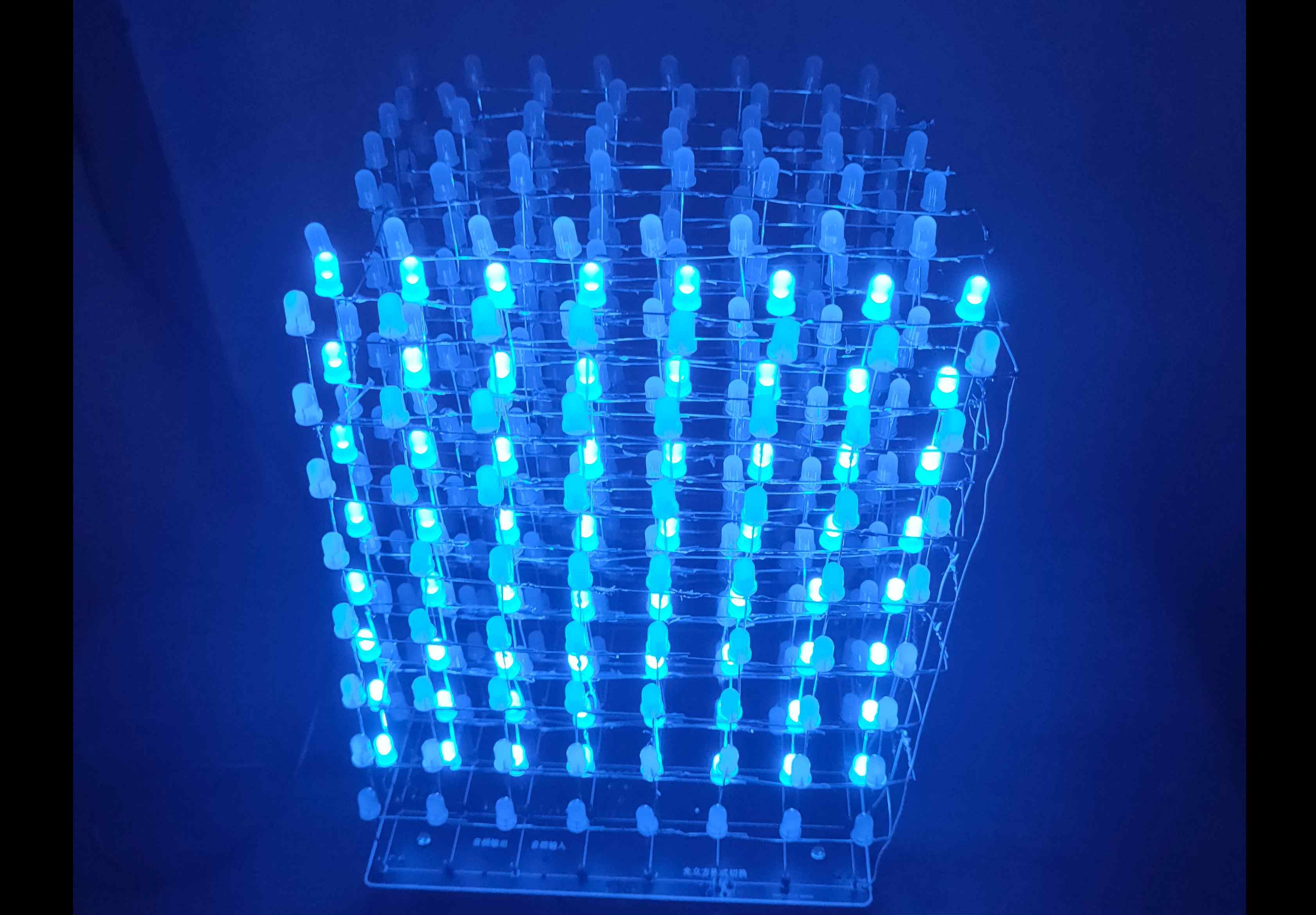

Lichuang EDA 2020 Summer Training Camp Basic Class Encouragement Award, based on the 8x8x8 light cube of STC12C5A62S2, using LELC to create a colorful 3D small world, using the 18*18 PCB version to make the cube larger and with better visual effects, using APM4593 The drive can ensure the stability of the current and prevent poor visual effects caused by too small current. Using the 595 chip greatly saves the port of the microcontroller, leaving room for future upgrades, and also adds an infrared remote control circuit, which can be used to adjust the animation effect. There is also an audio input terminal here, which can be used by Guanglifan Transforming into a three-dimensional spectrum greatly improves the playability of the light cube. There is nothing much to say about the bottom plate. Just solder it according to the components. For the lamp body, weld them row by row first, solder 64 rows, and then assemble the eight rows into one surface and insert it on the bottom board. Be sure to power on and check if there is any. There are no LED lights that are leaking. Those that are leaking need to be replaced. The order is as shown in my photo. (PS: Changing lights is a bit troublesome, so I changed a lot. If possible, wear anti-static gloves or bracelets to reduce static electricity.) There is something wrong with the template of the light board, which is caused by manual errors that were not considered. There are a lot of problems with LED lights not being able to be plugged in. The template will be slightly improved later. Regarding the infrared remote control, a certain treasure sells it for 2/3 yuan each, just search 51 remote control.
#Lighting up is really fun! ! ! You have to try it to find out! ! ! ! #
