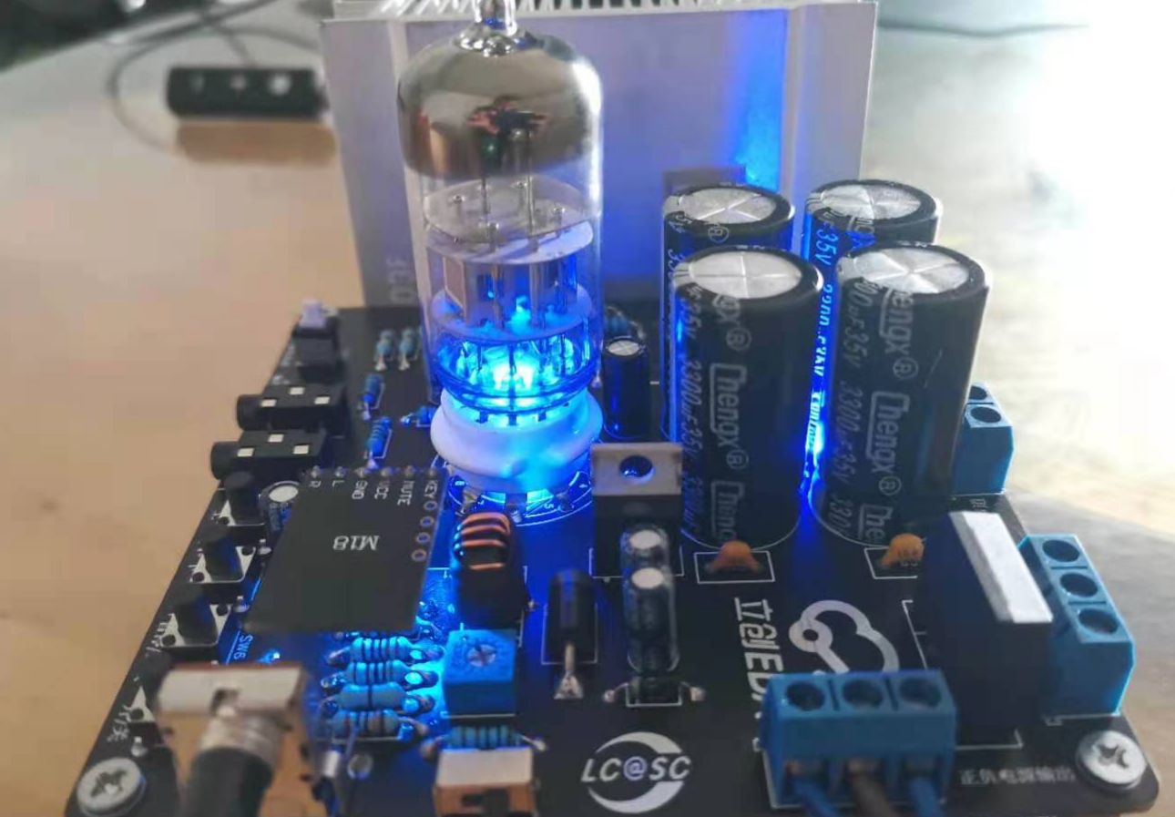

  • AUX audio input + Bluetooth input two-in-one 20Wx2 output analog power amplifier
  • 6N2 is the pre-amplifier + LM1875x2 post-amplifier
  • Vacuum tubes have the advantages of large input dynamic range and fast conversion speed; LM1875 is also an old friend of everyone, with ultra-low distortion rate, good output power, and protection against overload and overheating. As the core of this circuit
  • Adding Bluetooth diversified input methods, the transmission distance and efficiency are good.
  • Parameter Description
  • 1. In the power supply part, the main power supply is connected with a 3P terminal block. 2 input fuses to prevent overload and short circuit.
  • Main power supply range: AC12-18V
  • The preamp filament and Bluetooth board are powered.
  • Adopt DC-DC solution and use LM2596 to step down to +6.3v to power the 6N2 filament
  • The Bluetooth board is powered by the filament, which is filtered by LC and then dropped by D4 to power the Bluetooth board.
  • The preamplifier is a 6N2 from Dawn. There is a certain change in the timbre, and there is also a certain improvement in the listening experience. The circuit has not been added with any mixing or polishing, and is basically original.
  • The peripheral circuit of LM1875 is basically designed according to the official circuit diagram.
  • The M18 Bluetooth version is a ready-made module purchased from Taobao. It has LC filtering added to the power supply and four control buttons.

  • The long-awaited express delivery and PCB finally arrived. After welding, they fell directly into the ditch and could not work properly. After some analysis. I found that on the schematic diagram, VEE and GND were short-circuited.
  • Texture description, corrected in schematic.
  • Question 2: The PCB library package of 6N2 Xiaojiujiao is wrong (the pin position is wrong)
  • Texture description and library packaging have been updated. PCB needs to be updated.
  • Question 3: LM1875 self-oscillates (suspected to be caused by covering all the GNDs together). In this version, I used a button SW7 (also the preamp use/cancel button) to directly pull up to eliminate the oscillation, but this way the speaker will There is DC loss
  • Personal testing found that after pulling up, you can’t hear any self-noise and it doesn’t affect the music playback. Everything is normal.
  • Welcome to leave a message in the comment area and think of ways to reduce or eliminate self-excitation in PCB design.
  • Finished product display
  • Two 1875s and a CPU radiator are enough for heat dissipation. The speaker used in the picture is eight ohm and 15 watts.
  • Note: The PCB has not been updated, and the 1875 self-excitation cannot be used in the front stage yet .
  • This time is a pure post-level test .
