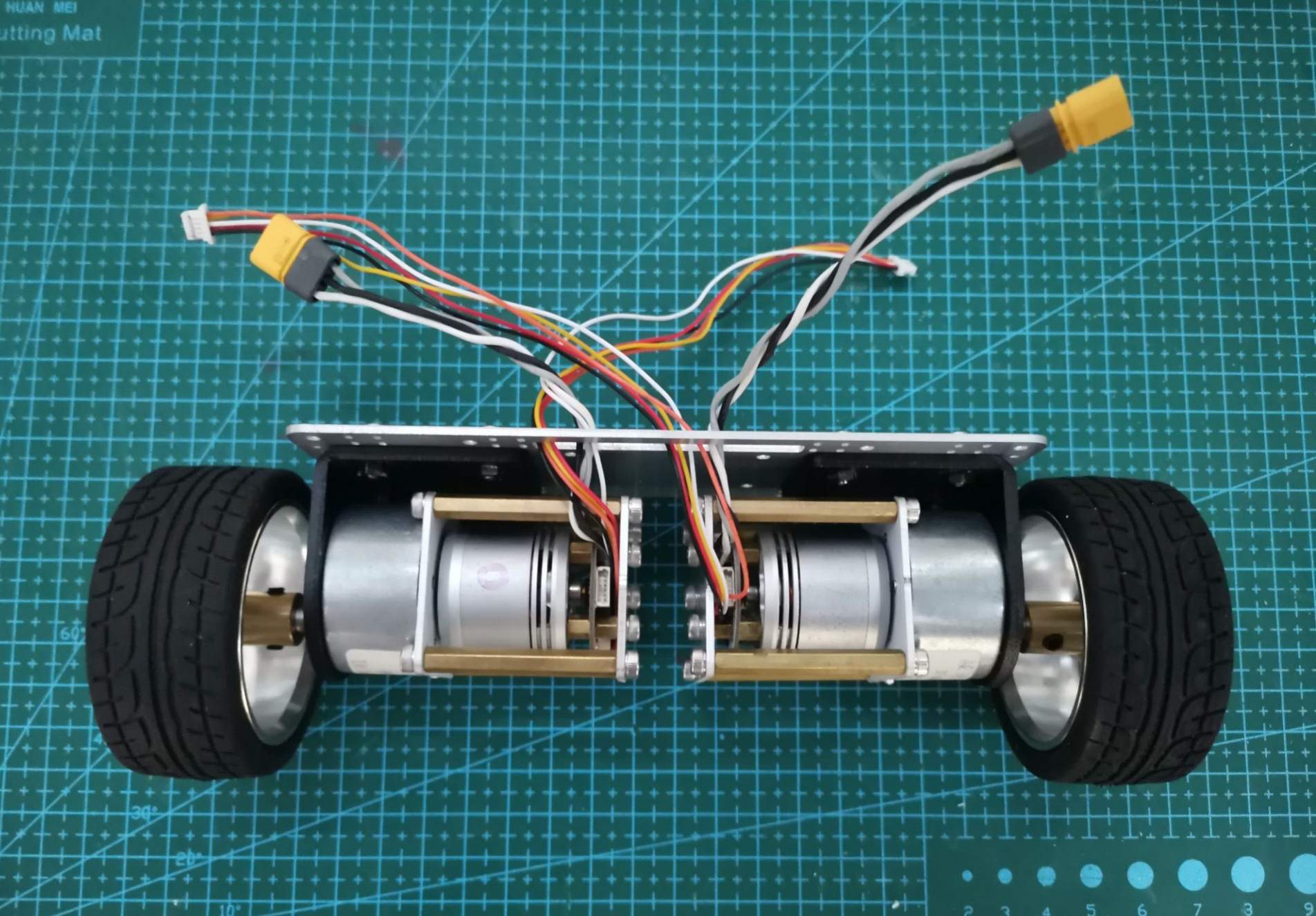

The project uses ART-Pi as the controller, imitation ODrive as the driver, and uses 2312S brushless motor, domestic MT6816 magnetic encoder, and MPU9255 gyro sensor (to catch a bug: module silk screen MPU9250, actual measured MPU9255, both can be used in this case) Universal), a two-wheel balancing car that uses PCB, copper pillars, and 3D printed parts as the frame. The controller program is based on the domestic embedded real-time multi-thread operating system RT-Thread, transplanted from the open source project https://github.com/stulwd/BalanceCar2 , and also referred to the project https://github.com/iamluoyijie/funny_car
Current progress: The driver for each device has been basically written and debugged, and the control algorithm has been transplanted. However, the balance car cannot yet stand up.

4. Motor——2312S+MT6816
5. Frame - PCB + copper pillar + 3D printing
