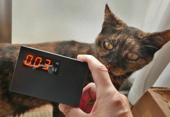

During the dry season we often get electrocuted by metal objects, especially door handles. This is due to the charged static electricity in the human body. Any object can be charged, and often objects have electrical potentials of several thousand volts or more. Static electricity often causes malfunction or damage to electronic equipment. I've always wanted to know how much static electricity is carried in an object or human body, so I made a surface potentiometer to measure the potential of a charged object.

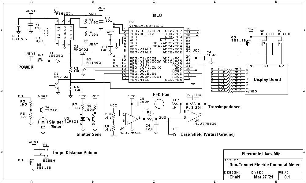

Blockdiagram
