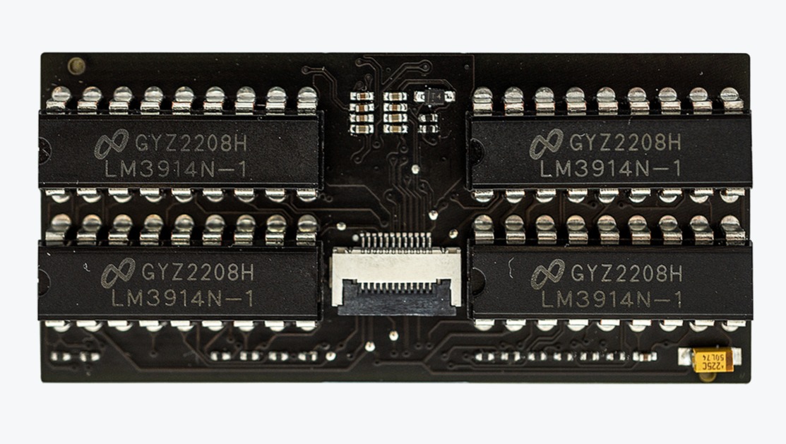

This is the display part of a multi-purpose indicator meter. It can be used in combination with the first part to form a source meter/ammeter, or it can be used alone as a meter head, which can be driven according to the interface protocol.
2. Application scenarios:
meter heads of ammeters, voltmeters, and UV meters
3. Product overview:
The meter heads use 40 LEDs as analog strips, driven by the LM3914 analog chip.
The current setting is dot display, with up to two LEDs lighting up at the same time.
The screen is a 0.96-inch white OLED screen, which can also be replaced with an I2C protocol screen of other sizes.
Use a 12pin flexible cable to connect. Please refer to the schematic diagram for interface definition.
4. Product parameters:
Analog strip: 40 LEDs, indicating the voltage value of 0-2.048V (default).
Screen: 0.96-inch OLED, display content can be freely defined.
There is also a WS2812B colored light for additional information display.

5. Instructions for use:
Analog strip
analog strip power supply, this project is set to 5V , can be adjusted according to your needs and the LM3914 chip.
The voltage range is: (voltage reference +1.6V) to 15V. Please refer to the LM3914 Datasheet for details.
The voltage reference affects the display range of the LED light. For example, the default is 2.048V. When the signal input voltage is 2.048V, the last 40th LED will be lit. The interval voltage of each LED is: voltage reference/40. It is recommended that this value be greater than or equal to 50mV to avoid overlapping display and making it difficult to distinguish.
If the voltage reference does not exceed 3V3, the power supply of the analog strip can also share the 5V power supply with the digital part.
