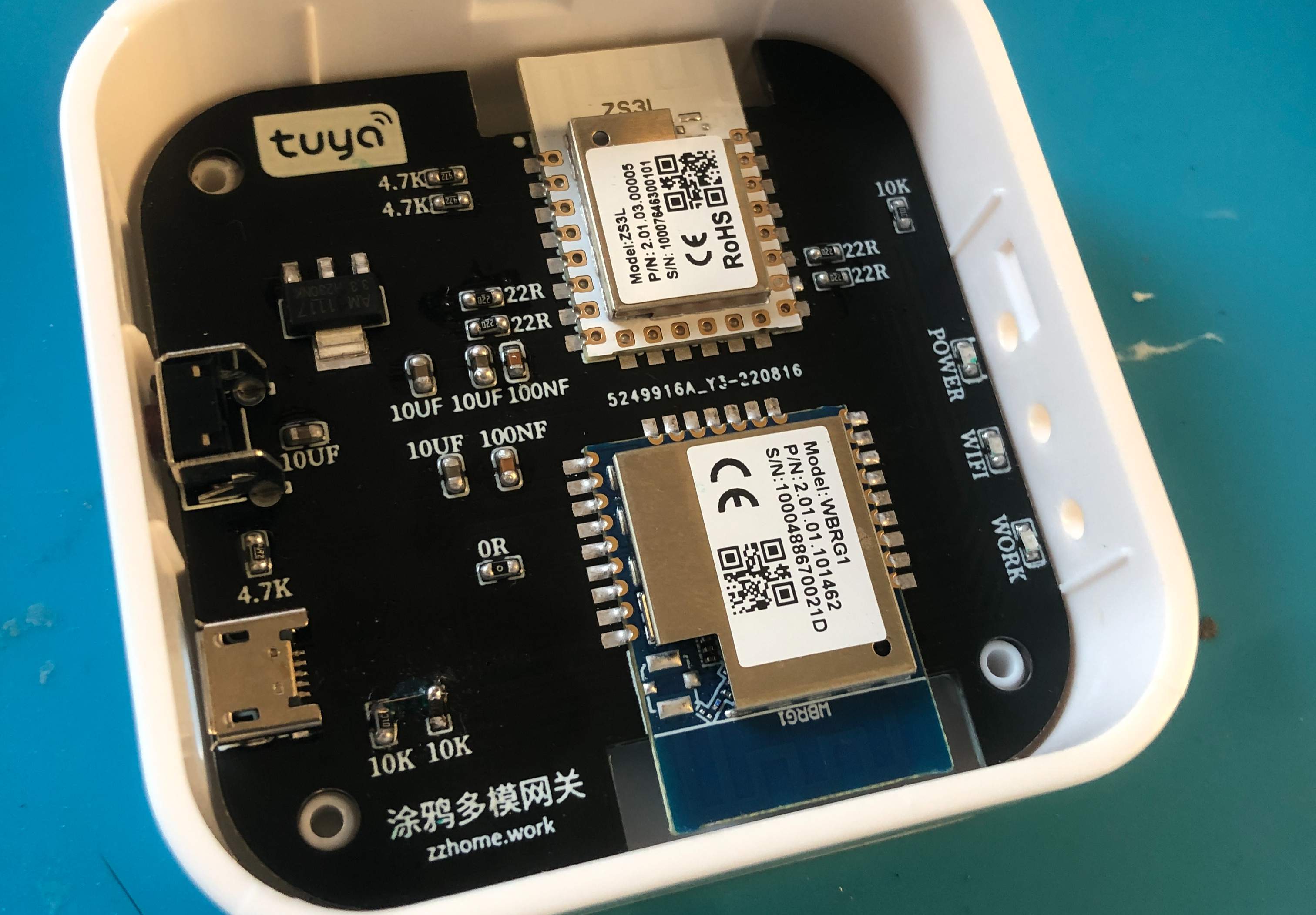

The PCB board is redrawn here to match the male module shell on a certain device. The project uses Tuya's development-free solution to implement multi-mode gateway design (only Tuya module access is available).
Male mold outer shell link: https://item.taobao.com/item.htm?spm=4754t.2.0.0.69002e8d6p8hoY&id=594355275944&_u=t3o1q0td2a4
The hardware only requires one LDO regulated power supply + two modules to implement. Very suitable for smart home scenarios
Engineering features:
1. WiFi+Bluetooth uses the Tuya WBRG1 module, and ZigBee uses the ZS3L module. Both models are free of development.
2. Three status indicators show the working status.
3. Press the button to add the device or configure the network for use.
4. Use AMS1117-3.3 for voltage stabilization and power supply.
