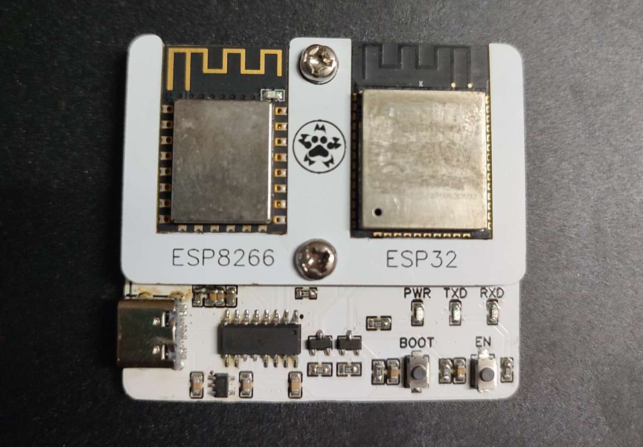

Use the antenna base as a spring piece, and the outer frame fits perfectly. Just put it in and press it.
If the program is large and the burning is slow, it is recommended to use a clip to clamp the middle of the module.
Board thickness 1.6, M3*7 or above screws
The middle board is a positioning board, the bottom board is coated with solder paste, and the antenna base is placed on it. Place the teppanyaki plate and it will automatically align.
