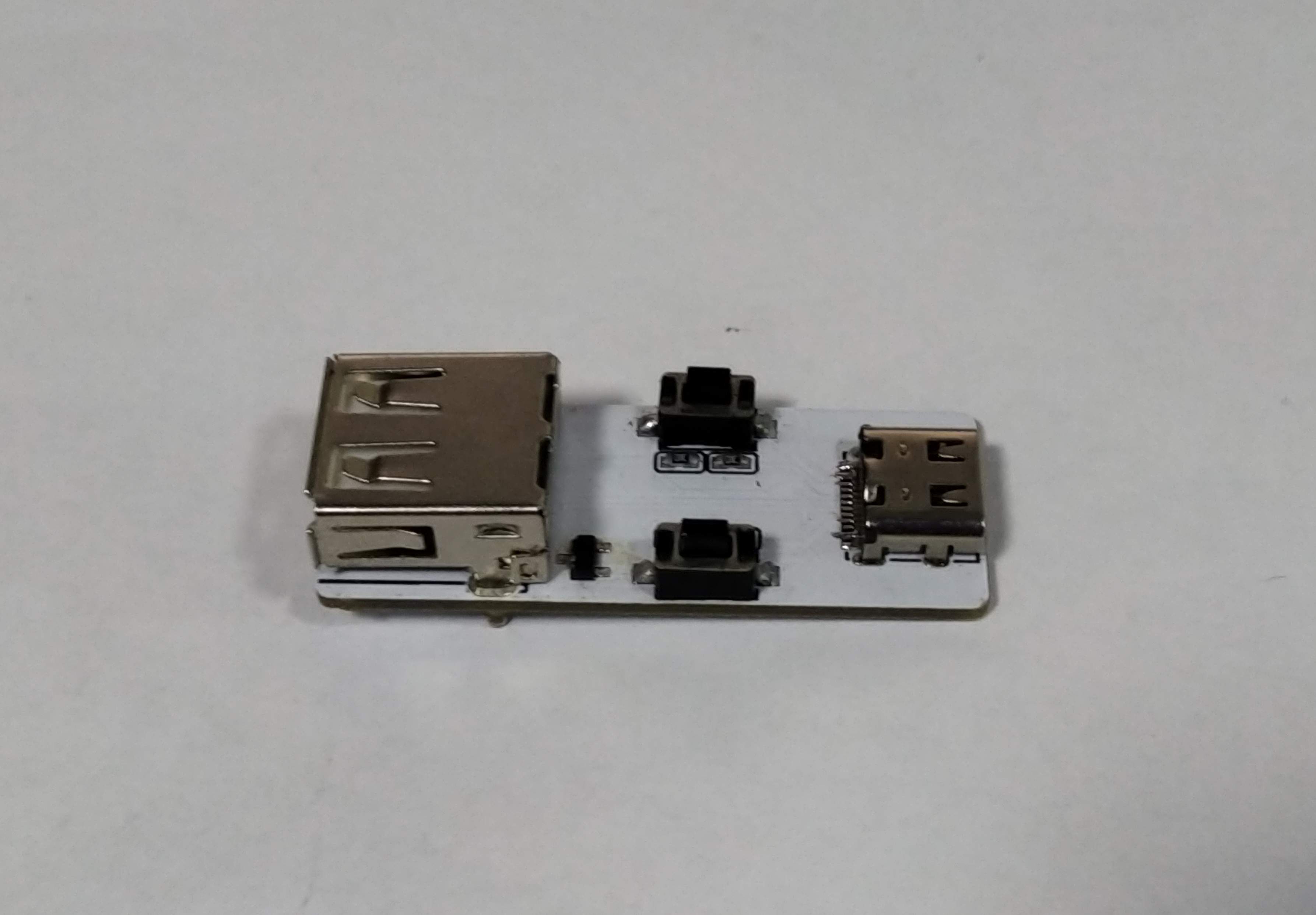

Cube-100_CH55X manual downloader
·CH55X chip program downloader
·Type-C port input, USB-A female port output
·Program download suitable for Nanjing Qinheng ch551g/ch552g/ch554g and other chips
·Press the Flash button to pull up the USB_DP signal
·Press the Rst button to turn off NMOS and cut off the back-end power supply
Usage steps: Press and hold the RST button, then press the FLASH button, and release the RST button.
