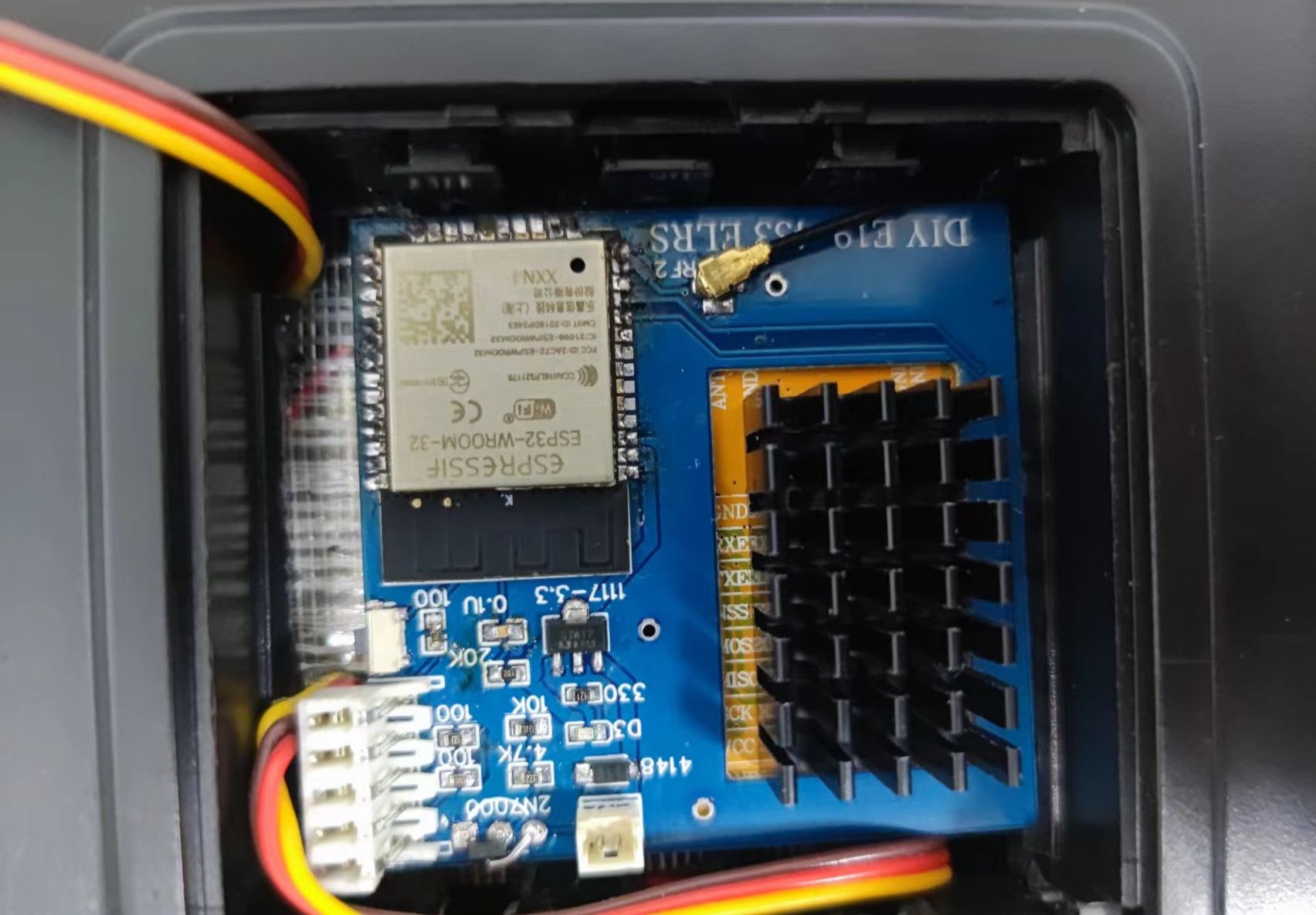

Fossil i6X model aircraft remote control battery compartment changed to ELRS tuner. Fits nicely into the battery compartment.
Adding a heat sink can only turn on 1W for a short time, but there is no problem in turning on 500mW for a long time.
The signal is 100% at a distance of about 5km, and further away it is limited by the fact that there is no test in the venue.
