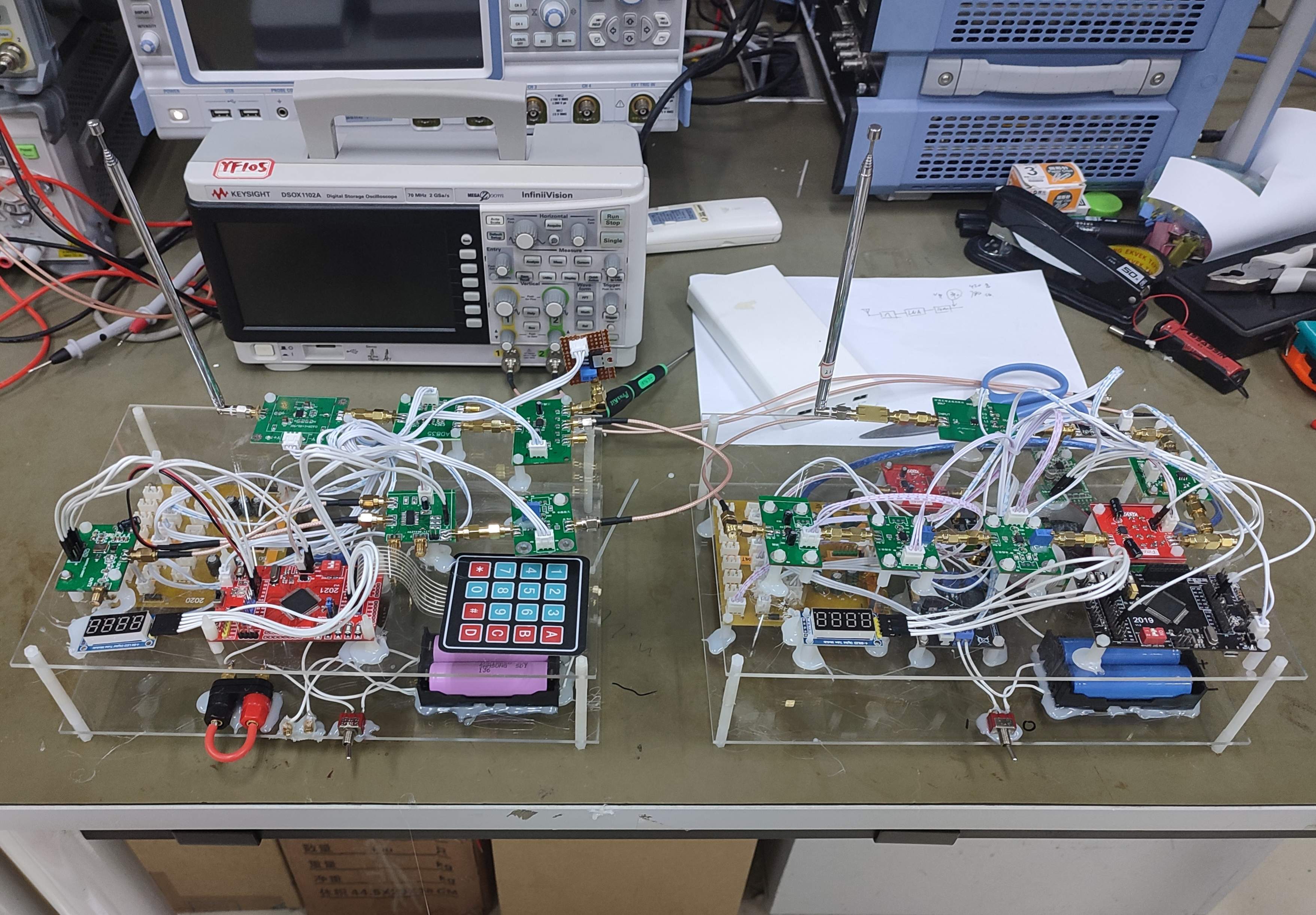

Video link: [https://www.bilibili.com/video/BV1ta411k7dG/](https://www.bilibili.com/video/BV1ta411k7dG/) # Foreword Affected by the epidemic, the e-sports competition will be postponed to November . The competition that I was supposed to participate in during the summer vacation of my sophomore year became a matter of my junior year, and winning the national award to secure my postgraduate studies was no longer possible. However, in line with the idea of ​​​​starting and ending, it can be regarded as an explanation for my two years of training, and I am still serious. After participating in the competition, after four days and three nights of twists and turns, I finally got the second place in the country. # Team introduction The team members are from the YF105 laboratory of Chongqing University of Posts and Telecommunications. YF105 laboratory is an undergraduate laboratory of Chongqing University of Posts and Telecommunications, with complete equipment and financial support. The three members are from the School of Communication and Information Engineering. Communication Engineering is responsible for writing microcontroller and FPGA codes. Electronic Information Engineering is responsible for the design and production of circuits. Hardware Electronic Information Engineering (girls) is responsible for report writing, theoretical analysis, and auxiliary hardware design. # The project analysis first posts the question requirements ![image-20211215125616720.png] ![image-20211215125642231.png] ![image-20211215125659340.png] ! [image-20211215125708489.png]     The highlighted text in the picture is what we did during the competition. The key points highlighted when analyzing the questions are because the main training questions in the first and second years of the freshman year are instrument questions, and the instrument questions are also selected when preparing for the national competition. Communication questions are only trained during the sprint training during the summer vacation of the sophomore year. We passed two questions, one was a dual-channel voice simultaneous interpretation, and the other was a spectrum analyzer. The purpose was to strengthen the ability of hardware design. Unexpectedly, after getting the questions, we only had question A to choose from, but after our analysis, we found the code of question A. The quantity was too large, and we had not used Ti microcontrollers much and did not know what potential problems there would be, so after half a day of discussion, we finally took a gamble and chose question E. Since this is the third high-frequency question we have done, we have little experience. In addition, we have just started to learn communication principles. We have just finished learning the analog modulation part and have not learned digital modulation yet, so for those very high-end modulation methods No, other high-end methods will not be analyzed here. We spent half a day looking through books on communication principles and felt that the 2ASK modulation method was better and not difficult to implement. After rigorous theoretical analysis, we found that it can meet the bandwidth requirements. So decided to use this method. But the problem came again. We used FM modulation during the summer vacation. This time we used AM modulation. The FM demodulation during the summer vacation confused us. It was too difficult to demodulate, and the AM demodulation was incoherent. The circuit is so simple that one can't help but doubt its authenticity. The second is the antenna. I can’t make it myself. I can only use a ready-made rod antenna. However, impedance matching is a big problem. The Smith chart theory is really different from reality. Whether it can be matched depends entirely on luck. That’s a problem during summer vacation. Question: It took me two days to match the antenna. So there are a lot of questions. #Theoretical Analysis and Calculation## Overall Description This work designs and implements a digital-analog signal hybrid transmission transceiver. The work is divided into two parts: the transmitting end and the receiving end. The transmitting end adopts the idea of ​​frequency division multiplexing, and inputs numbers through the keyboard. After digital encoding, it is converted into a 2ASK (binary amplitude shift keying) signal with a center frequency of 11.5KHz. This signal Added with analog signals within 50Hz~10KHz, digital-analog combining is realized; the combined signal is amplified and sent after AM modulation; the receiving end first uses band-pass filtering and low-noise amplifier to process the signal, and uses envelope detection to The processed signal is subjected to AM demodulation, and a digital filter is used to separate the 2ASK signal containing the typed numbers from the analog signal. The analog signal is output after shaping and processing. The 2ASK signal is converted into a square wave and entered into the microcontroller for decoding, and the decoded numbers are sent to the receiving end. show. Actual measurements show that the work achieves mixed transmission of 50Hz~10KHz analog and digital signals, the channel bandwidth is not greater than 25KHz, the transmission distance is greater than 1 meter, the analog signal has no obvious distortion, and the digital signal is displayed correctly. ## Solution Demonstration Analysis ### The 20MHz~30MHz carrier solution demonstration analysis originally planned to use AD9959, which is a DDS chip, and has ready-made modules and ready-made codes. The highest frequency can reach 300MHz, so it is completely satisfactory. , and very convenient, but a fatal problem is that its power consumption is too large, and the working current can reach 300mA. When we use the signal source as the carrier, the overall working current is only 120mA, which is obviously not acceptable. of. The second is to use a phase-locked loop. This is difficult to do. I have never done it before, so just pass it. Then the simplest method was adopted, using a crystal oscillator plus filtering, and switching crystal oscillators of different frequencies to achieve carrier conversion. However, their frequencies were quite different, and they had requirements for antennas, so they had to give or take, and finally achieved the effect. It is very good. The passive filter should be made steeper and the spurious frequencies should be filtered out, so that the transmitted spectrum information can be clean. After the game, we found that the AD9854 DDS is very good, with an operating current of only 20mA, which is undoubtedly very convenient. We bought it and the effect is very good, but we need to pay attention to the impedance matching between it and the multiplier, otherwise the signal will be reflected back and produce intermodulation distortion, and the spectrum will be impossible to see. ### Signal synthesis cannot be developed separately. The question requires that one channel be transmitted together, so there are frequency division multiplexing, time division multiplexing, and of course code division multiplexing. This is too complicated and will not be considered. Time division multiplexing is a scheme that interweaves different signals in different time periods and transmits them along the same channel. At the receiving end, a certain method is used to extract the signals in each time period and restore them to the original signal. communication technology. This solution has stronger anti-interference ability, but requires an accurate clock signal to determine the type of transmitted signal, and the implementation is more complicated. Frequency division multiplexing, the transmitter transmits the voice signal in one frequency band, and the digital signal is encoded and converted into a 2ASK signal for transmission in another frequency band. The two channels of voice signals with different frequency bands are synthesized into one signal through an adder, and the receiver then combines the two channels. The signals are restored separately. The advantages of this solution are high channel utilization and relatively simple implementation. Two signals can be transmitted simultaneously. The disadvantage is that there is a channel bandwidth limit in the question. The distance between the two frequency bands is not far enough. The receiving end needs a filter to separate the two signals. Very high roll-off coefficient, but we solved this problem with digital filtering. ### The modulation method adopts the AM modulation method. AM changes the amplitude of the carrier signal waveform so that the amplitude of the AM modulation waveform changes with the change of the synthetic signal waveform. AM modulation can be achieved by passing the synthetic signal and the carrier signal through a multiplier. The advantage of this solution is that it has fewer circuits and is simple to implement. The disadvantage is that the anti-noise performance is weak and the long-distance transmission loss is large. However, we only transmit a distance of 1 meter, so its shortcomings are tolerable. The FM modulation method is used to carry the synthesized signal at the frequency of the carrier. This can be achieved by feeding the signal back to the input of a voltage-controlled oscillator. The advantage of this solution is that it has stronger anti-noise capability, but the circuit is relatively complex, especially at the receiving end. demodulation. ### Overall plan The system is divided into two parts: the sending end and the receiving end. Type a set of 4 numbers on the numeric keyboard at the sending end. The STM32 stores the numbers and displays them on the digital tube. The numbers are encoded and converted into a 2ASK signal. This signal is combined with the voice signal generated by the function generator. The combined signal is modulated by AM. Send, AM modulation carrier frequency is optional; after the receiving end receives the signal, it goes through a low-noise amplifier to amplify the received weak signal, and band-pass filtering reduces the noise. After the signal undergoes envelope detection, a digital-analog mixed signal is obtained, and the signal is filtered by FPGA The voice signal obtained is directly displayed on the oscilloscope. The filtered digital signal is converted into binary symbols and passed to the microcontroller. After processing by the microcontroller, the numbers are displayed on the digital tube. ![image-20211219113505406.png] ## **Theoretical Analysis and Calculation** ### 1. Digital-analog signal combined analysis (1) Digital encoding and decoding In order to synchronize the data sent and received by the receiving end and the transmitting end, we It specifies the communication protocol between the sender and the receiver, as shown in Figure 2. 30 symbols are sent at a time, the symbol rate is 40Hz, the maximum data value is 9999, the corresponding binary code is 10011100001111, and the length is 14bit. We are in the data Add 1 bit of data at the beginning. When 1 is received, the data begins to be transmitted. The microcontroller receives the data and adds 15 bits of 0 at the end of the data. ![image-20211219113712541.png] (2) The combined speech signal of the two-channel signal is analyzed using the sinusoidal signal as an example, and the speech signal generated by the signal generator is recorded![image-20211219114051837.png] Formula (1): ![image -20211219114103241.png] Among them, ![image-20211219114217428.png] is the voice signal amplitude, ![image-20211219114229494.png] is the voice signal frequency, ranging from 50Hz to 10KHz. The digital signal is encoded and converted into a 2ASK signal. In order to separate it from the frequency band of the voice signal, the carrier frequency of 2ASK is selected as 11.5KHz, that is, ƒc0 is 11.5KHz, 2ASK signal! [image-20211219114310358.png] as shown in equation (2): ! [image-20211219114319171.png] Among them, ![image-20211219114356777.png] is the input code element, the value is 0 or 1, ![image-20211219114406741.png] is the binary code element period, ![image-20211219114414503.png ] is the carrier signal amplitude. The 2ASK signal bandwidth is twice the baseband bandwidth, so the baseband bandwidth cannot be too wide. From the analysis in the previous section, we can see that within 2S, we need to transmit 30 symbols, so the symbol transmission rate! [image-20211219114506592.png] , We choose![image-20211219114534356.png] =40bit/s to send symbols. At this time, the bandwidth of the 2ASK signal is![image-20211219114616539.png] . The two signals are added through the adder to obtain the combined signal as shown in Equation ![image-20211219114643171.png] (3): ![image-20211219114659266.png]
