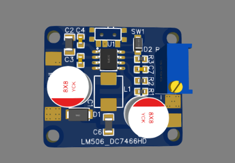

This project is an adjustable module for the DCDC chip picked up in the 15 yuan brand coupon Zhonghetai Brand Coupon in April. The main control is HT7466.
Input voltage 4.75-24V
Output voltage 1.222-20V
The schematic diagram shows common resistor-corresponding voltage settings. An adjustable-voltage output circuit has been designed, and several other sets of available resistor settings are also provided with text labels.
Switching frequency 380KHZ, simple peripherals, small size, input and output current not more than 3A
Use the EN pin to control chip operation, high level = operation
