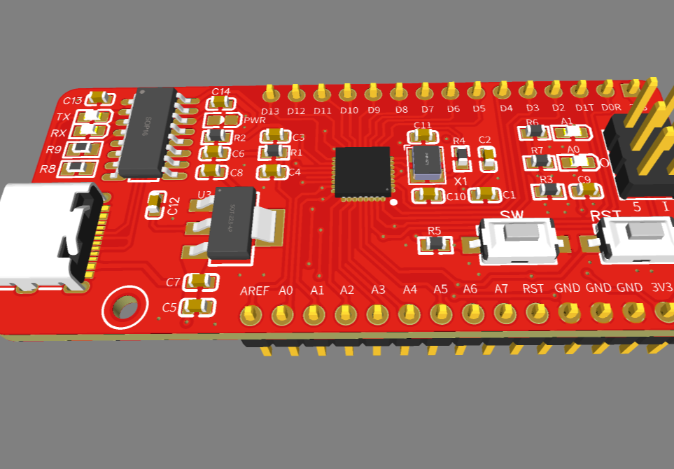

Some time ago, I bought a set of Haoxiang ToF module and 4-in-1 ESC for RMB 48 (picking up trash), which contains 4 ATMEGA328P-MU microcontrollers, so I drew this Arduino development board.
This project is based on this solution verification board, adding a serial port download module, TYPE-C interface, etc.
https://oshwhub.com/li-chuang-zhi-neng-ying-jian-bu/atmega328pb-au-fang-an-yan-zheng-ban_transfer_transfer_transfer
1. Solder PCB
2. Burn Bootloader for the chip

3. Serial port download test
Open Blink in the example and use the USB-TTL downloader to connect to the Arduino development board:
Downloader--Arduino development board
GND---GND
RXD---D1 (TXD)
TXD---D0 (RXD)
5V------VCC
 The author uses a 16MHz crystal oscillator . Select the download method as shown below. 8MHz selection (3.3V, 8MHz), the chip supply voltage is 3.3V
Notice:
This 0.1uF capacitor realizes automatic downloading without pressing the RESET button every time it is downloaded.
