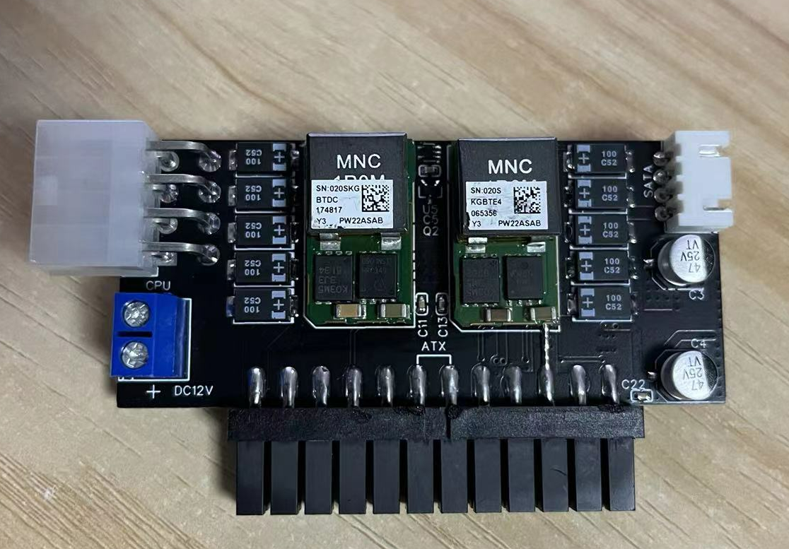

Refer to the solution of Harry_2005 on the site. It has been verified and functions normally. The test platform is AMD 3000G+A320. The theoretical maximum current is 15A. It is recommended to install a fan or heat sink for large load platforms.
