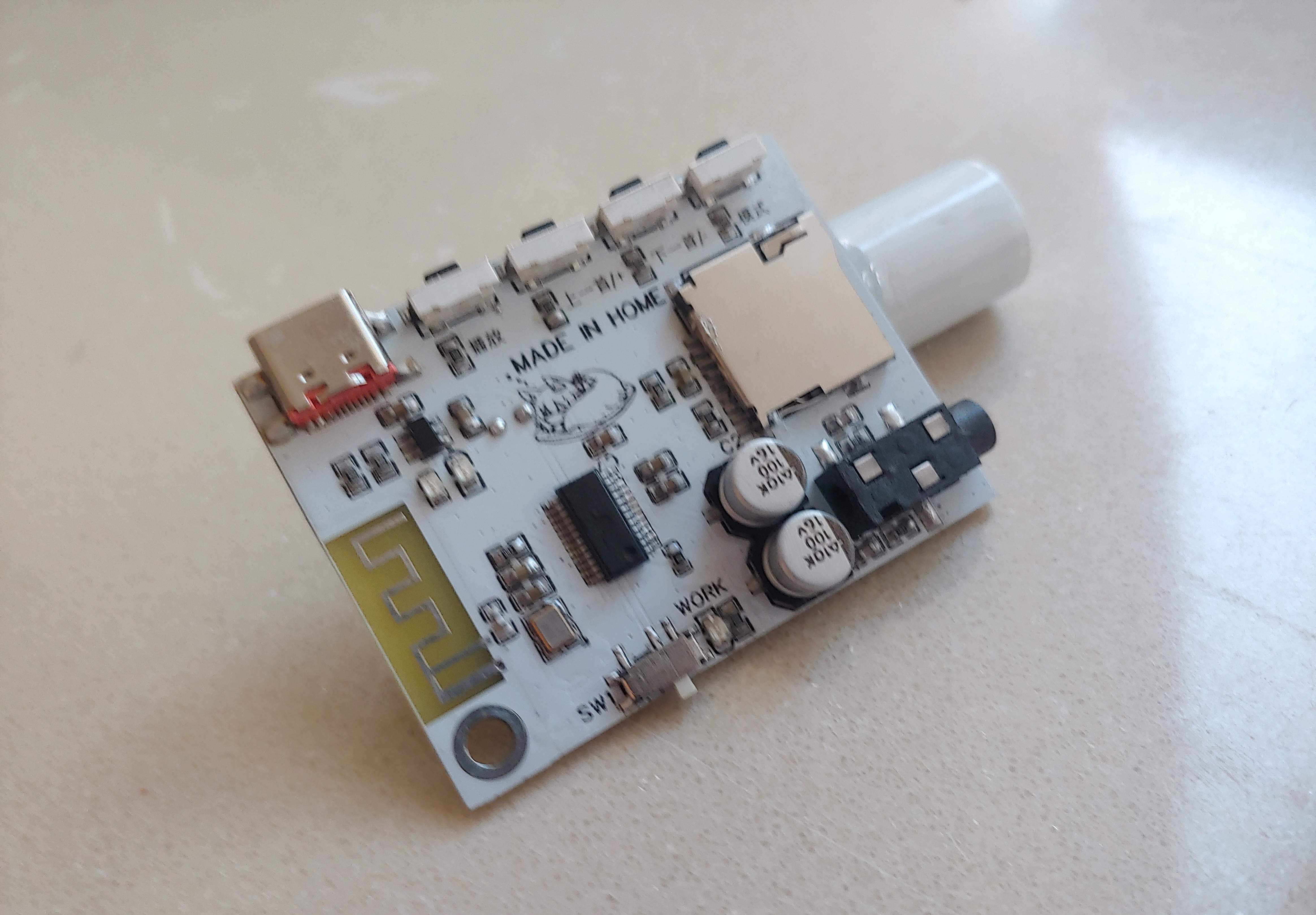

SUPERHIFI mp3 based on ac6905a
The main control IC is Jerry's AC6905A, which has low power consumption and simple peripherals.
It mainly reads music files through TF cards (actually measured, it can read TF memory cards with a capacity of up to 128G). It is equipped with a Bluetooth function and can output music from Bluetooth through the headphone jack. The audio signal
is equipped with a TP4057 charging chip, with dual lights (yes/no) to indicate charging completion status (although I have never seen this thing light up)
amgpDQ22Y2IW0JgAUtOT45L9zLSJuaSiQF4AFN6p.jpegand four-button control, which can switch TF card reading/Bluetooth receiving mode. Pause/play, Next song/volume+, previous song/volume-
toggle switch control switch (seems like nonsense), with power-off memory
