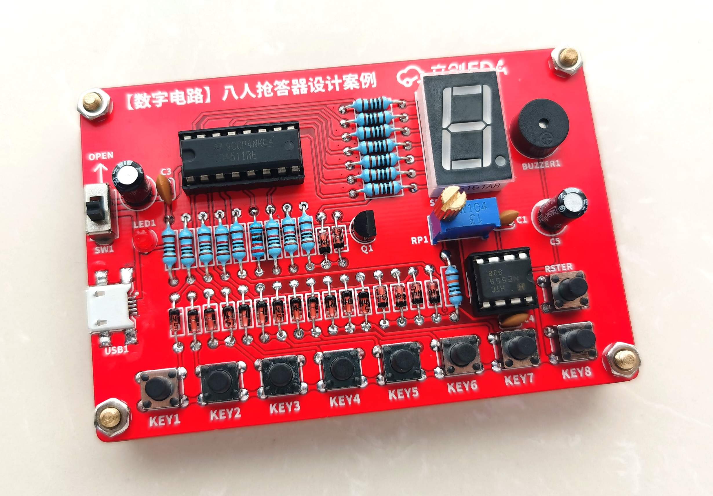

7 焊接与调试
7.1 硬件焊接
  After getting the board and components, you should first check whether the materials are missing or missing, and then proceed with welding after checking them. The welding principle is to start low and then high. First weld the USB , resistor and diode to the board, then weld the capacitor , transistor and IC holder, and finally weld the buttons , buzzer and digital tube. After completing the welding, plug in the NE555 and CD4511 chip . The welding method of direct plug-in components is shown in the figure below. Pay attention to the correct position when welding, check whether the component model is correct, and whether the tin wire is soldered to avoid affecting the circuit performance and causing the circuit to not work properly.
Figure 7-3  PCB assembly diagram
Figure 7-4  Unsoldered PCB board
Figure 7-5 PCBA physical diagram
Figure 7-6 PCB-3D preview
7.2 Hardware debugging
  Insert the data cable into the Micro USB to power the eight-way answering machine project. Move the switch to the OPEN state, the power indicator light will light up, the digital tube will display zero, and the answering machine will enter the waiting state. When the answer key is pressed, the buzzer will sound. Adjust the resistance of the potentiometer so that the buzzer sound reaches the best state. The digital tube displays the corresponding number of answer keys. When the reset button is pressed, the digital tube display is cleared. The answering machine enters the next round of waiting state.
Figure 7-7 Working diagram of the eight-way intelligent answering machine
