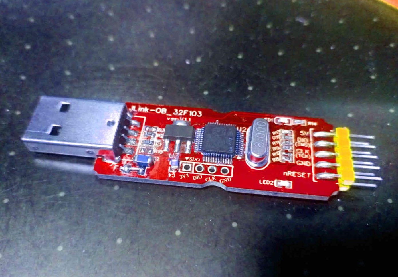

J-LINK beggar version stm32f103c8t6 domestic core available
Original version: JLink-OB_32f103 - Lichuang EDA open source hardware platform (oshwhub.com)
Modified version content:
1. Cheaper power chips
2. Cheaper crystal oscillator
3. Remove USB protection
This version of JTAG firmware may not support ESP32 debugging.
I checked the information on the external network. It may be a bug in the communication between openocd and this version of JLink.
Warn: Failed to send data to device: LIBUSB_ERROR_TIMEOUT.
to verify available
For specific usage, please refer to the original open source
