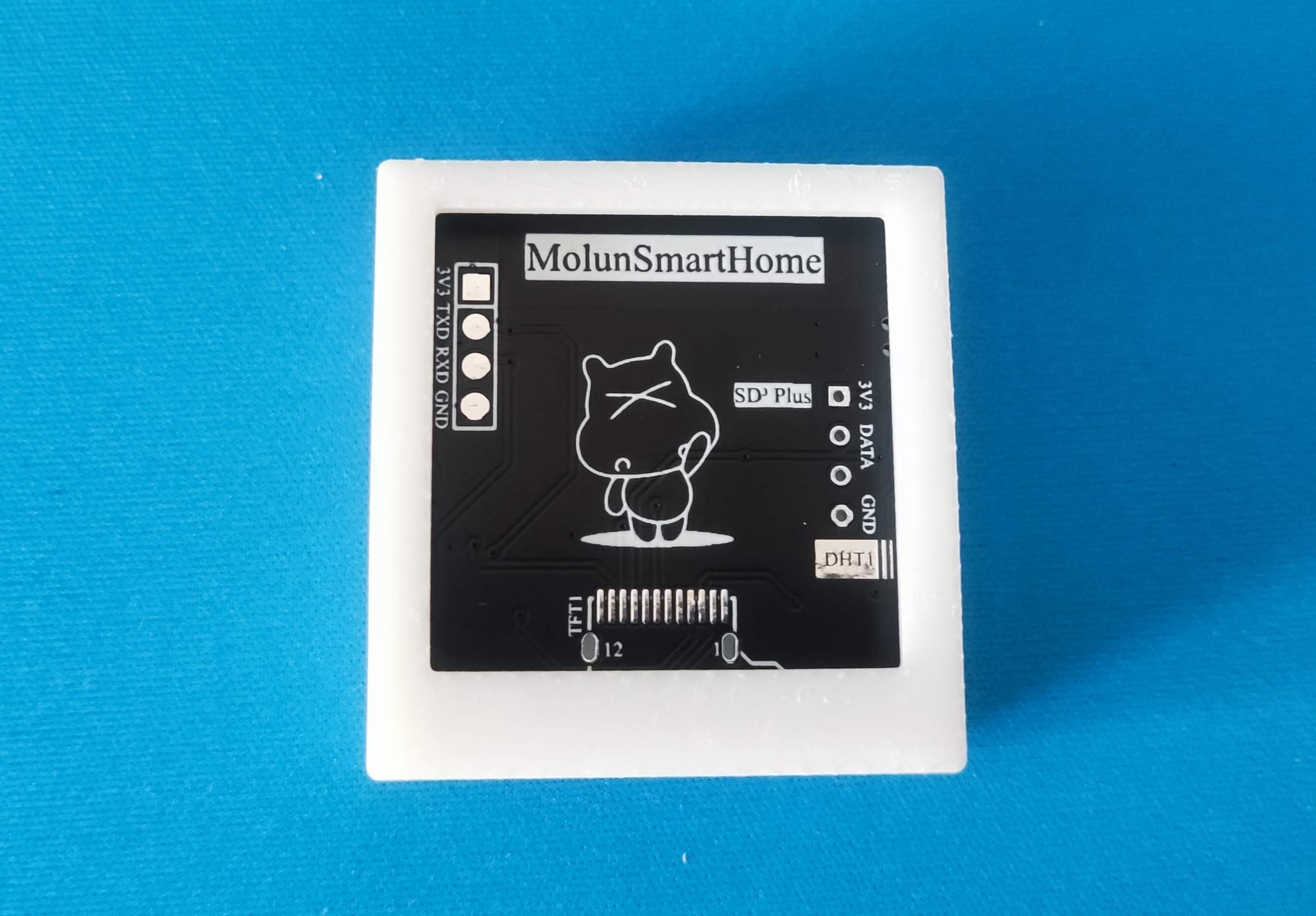

The reason why it is called this name is because I want to reproduce the SD³ small TV. After making the board, I found that the existing components lacked the side-pressing turtle button. The PCB thickness was made to 1.6mm. The original project recommended 1.2mm PCB, otherwise it would not be possible. In its original shell!
The author of the original project used AD design. There are always some problems after importing Jialichuang EDA. In addition, the boarding rules are about to change, and the threshold for replicating has been raised. In addition, the original shell cannot be used in 3D Monkey for free. Place an order. Since the project is relatively simple, I modified a version and used Jialichuang EDA Professional Edition to draw the PCB and generate a 3D shell. You can order and print it for free on 3D Monkey.

Instructions for modification of SD³ Plus temperature and humidity version compared to the original version
  • PCB layout modification
  • Add DHT11 temperature and humidity sensor interface, you can choose whether to weld or not
  • Added DET420 buzzer, hardware reserved, there is no function setting at the moment, brothers who know the code can modify the relevant code, thank you, and provide alarm clock and other functions (V1.1 version, removed in V1.2)
  • Adapted to the PCB shell, it can be drawn by Jialichuang EDA professional version and can be 3D printed for free on 3D Monkey. There are many modified versions of the shell, and 2 types have been verified to be feasible.
  • All component BOM sheets can be ordered at Jialichuang One Piece. Of course, the price is more expensive, so you can buy them yourself at major electronic component malls or Taobao. Don’t forget that you can also buy it from Xinchacha!
  • The shell size is slightly smaller than the Mijia Bluetooth Thermohygrometer 2, and the thickness is thicker than the original version, at 20mm.
  • The firmware burning pad is reserved, and the CH340N serial port chip does not need to be soldered.
  • The ST7789V_TFT_1.54 screen driver is different. This time we use the schematic recommended by Zhongjingyuan and use S8050 to drive the screen.
  • The module IO is exactly the same, it is recommended to use the 1.4.2 SD3 PLUS optimized version firmware

There is a hole in the center of the bottom case (top cover), which is the temperature and humidity detection window for the DHT11 temperature and humidity meter. It is not yet known how the working temperature of the ESP-12F will affect the measurement accuracy of the DHT11. After all, the two are so close! The DHT11 pins are bent 90° and soldered to the motherboard. The thickness of the upper cover can be reduced without the need for temperature and humidity sensors.
There are four holes on the side, facing the DHT11 pad. You can insert the DHT11 pins and solder them. That is, the DHT11 is placed outside the shell, which may look a bit awkward.
There are RST and FLASH buttons on the left and right sides, and the Type-C interface is below.
The upper and lower shells are fixed in the same way as the shell. The diameter of the modified hole is 1mm. You can use toothpicks or printing posts to fix the upper and lower shells.
The bottom case (upper cover) is equipped with four raised support pillars, mainly considering DTH11. There are grooves inside the case to place magnets with a diameter of 5mm. The one I bought is 0.5mm thick. Stack 2 to 3 pieces to ensure that the magnetic force can make SD³ Plus temperature and humidity version can be adsorbed to the computer case!
