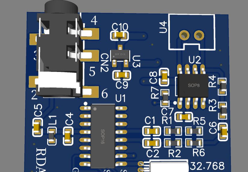

RDA5807, no matter what the suffix is, the code is the same. This sop16 package has an additional I2S digital audio output interface, which can be connected to an audio chip that supports I2S to directly output digital audio.
The chip supports receiving RDS broadcast information [that is, inserting some special information, the most common one is the traffic information broadcast on the vehicle radio]. References --> https://www.renrendoc.com/paper/194401939.html
It doesn't matter whether IIC is pulled up or not. Anyway, STM32 has built-in pull-up [just don't need open-drain mode].
In order to ensure a better sound pickup effect on the drawing, all are drawn first. However, in actual soldering, some components cannot be soldered. As long as the function is OK, as few as possible.
