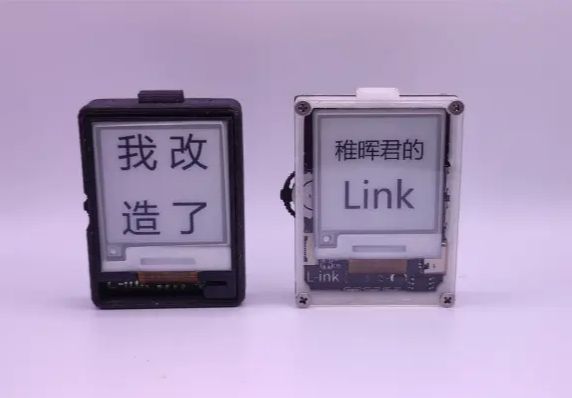

3. Major improvements
  • 1. Appearance, the middle frame is made of transparent 3D printing, which is divided into upper middle frame and lower middle frame. The cover is cut from acrylic. The printed file and acrylic frame will be placed in the attachment! !
    Fixing method: Use 4 screws on the front and back. The screws on the front are M2x3 and the screws on the back are M2x6.
  • 2. Change the button battery to a lithium battery, model 502025, and match it with the onboard 4056 charging circuit. Due to the small battery capacity, in order to reduce heat generation, the charging current is limited to about 200ma.
  • 3. The power button is moved to the side, opposite to the dial switch, which facilitates one-handed operation. A function button is added, connected to the stm32 GPIO, with customizable functions. It is used as a power display button by default. How to use: Press the function button and then press the power button to turn on the computer and automatically enter the power display interface. Because the board will pull down the voltage and the power algorithm is not perfect, the power is for reference only and may fluctuate! !

7. Results chart
Two renderings are shown below. For specific demonstrations, please go to Station B.
Front:
Back:
