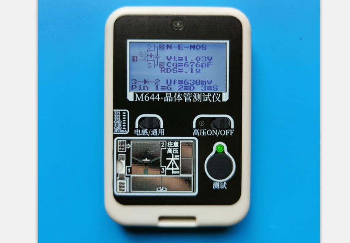

M644 transistor tester G01
The remodeled version of G01 puts old wine in new bottles.
The shell requires several layers of processing by an engraving machine. If you are capable, you should do your own 3D drawing.
This version is relatively small and light, and the integration is relatively high and compact. The main PCB is a 4-layer board thanks to JLC's free prototyping, and the others are ordinary double-layer boards.
Project open source address:
Original forum post   https://www.mikrocontroller.net/topic/transistortester-avr?page=1
New download address of source code   https://github.com/Mikrocontroller-net/transistortester
LCD screen JLX12864G-132, LCD module, COG LCD screen, 128*64 dot matrix, FSTN serial port (avoid advertising and search on Taobao by yourself)
Knurled nut, M2, D3.2*H4mm, 6 pieces
M2*2mm screws, 12 pieces
Cable, 0.5mm reverse 20pin, 5cm
