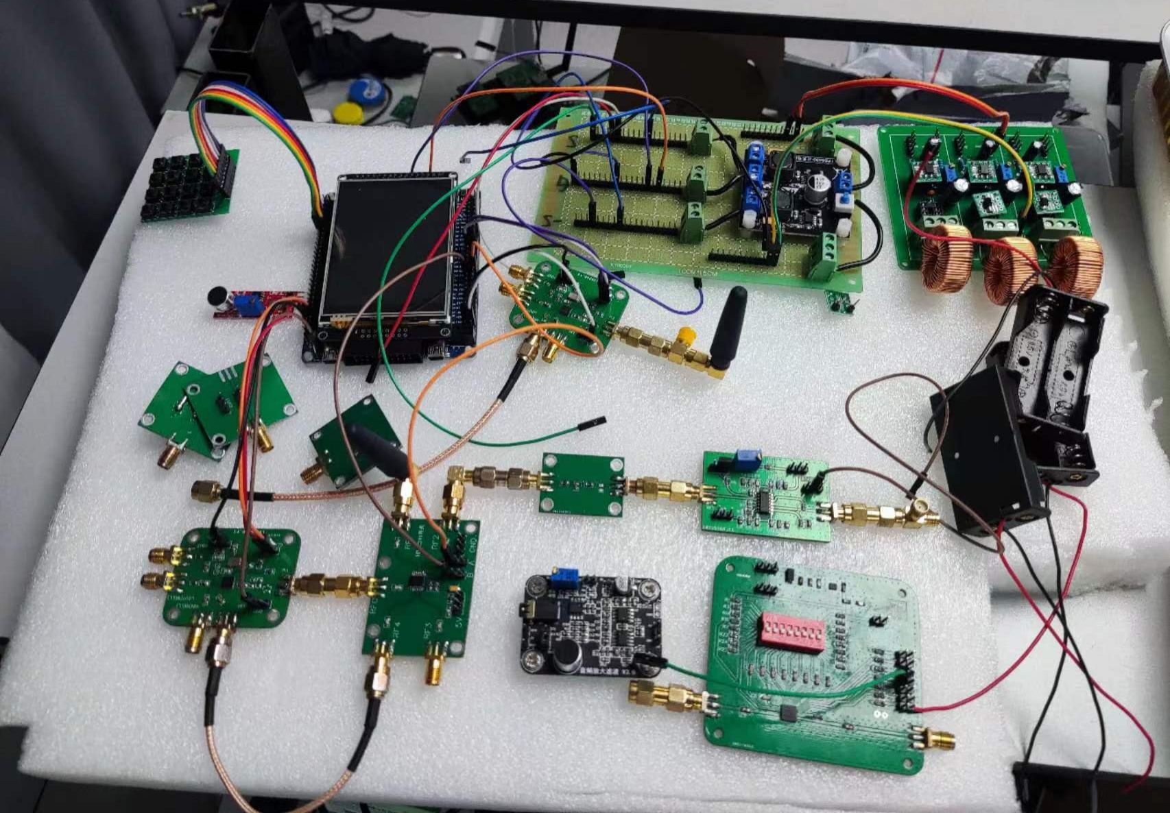

This system uses STM32F103 as the control core, uses RDA5820 integrated FM transceiver chip to build an analog frequency modulation circuit, and realizes arbitrary setting of the carrier frequency. It uses an adder and demodulation circuit to create a receiver that can mix sound amplification, and uses RSSI channel occupancy detection Algorithm enables the microphone to automatically detect channel occupancy when turned on and avoid interfering signals. The wireless microphone is powered by dual batteries +3V. It can output a carrier frequency between 88MHz and 108MHz, and can be set arbitrarily with a step frequency of 200KHz. The maximum frequency deviation is 75kHz, the audio bandwidth is 40 Hz~15 kHz, and the antenna length is less than 0.5 meters. And when two microphones are used at the same time, the carrier frequency can be automatically selected within 0.5 seconds after turning on to avoid interference signals; the receiving part adopts a self-designed and produced circuit, with a receiving distance of more than 10 meters, a maximum output power of 0.5W, and realization of The acoustic signals of the two microphones are amplified or mixed amplified respectively.
After final cascading and debugging, the system achieved all the requirements of the question. Some indicators such as communication distance, automatic avoidance response time, maximum audio output power, etc. all exceed the question requirements, and the transmitter power achieves low-power output while ensuring communication quality.

The two microphones are mainly composed of FM transceivers, RF power amplifiers, power supply circuits, and antennas. The entire system is powered by two 1.5V dry batteries. The receiver consists of an antenna reception, FM transceiver, inverting adder, audio power amplifier, and speaker. The microphone part is spectrum analyzed by the microcontroller and adjusted to the appropriate frequency in the shortest time through the quick sorting method. The receiver part can mix audio and manually adjust the volume. The overall system adopts a two-transmit and one-receive structure. The block diagram is shown in Figure 1:

RDA5820 is a very highly integrated FM transceiver chip. The chip has the following features: FM transmitter and receiver integrated, supports global FM receiving frequency band of 65MHz-115MHz, and supports IIC/SPI interface. As the core chip of this system, RDA5820 is responsible for modulating and demodulating audio signals. The chip communicates with the microcontroller through IIC communication. The RDA5820 schematic diagram and PCB layout are shown in Figures 2-1 and 2-2.
Figure 2-1 RDA5820 schematic diagram Figure 2-2 RDA5820 schematic diagram
In Figure 2-1, the audio socket interface connected to the FMout pin is replaced by a whip antenna with an SMA interface. L1 is set to 100nH to match the antenna to reduce power loss caused by reflection.

In order to meet the long-distance transmission requirements, OPA695 is used to amplify the power of the modulated signal. Among them, R1 and R2 determine the gain coefficient, and R3 and C1 are used to filter the DC component of the input carrier signal. Rout is impedance matched to avoid reflection. The schematic diagram is shown in Figure 4:

4.1 Testing and result analysis of microphone output signal frequency range and step interval
       Test plan: Increase the frequency of the carrier signal step by step, observe the transmitted signal with a spectrum analyzer, record the center frequency point, and record the lowest and highest carrier frequencies.
Test conditions: The frequency sweep range of the spectrum analyzer is 70~130MHz, and the input attenuation is -20dBm.
Test results: The lowest frequency of the carrier signal is 88.00032MHz and the highest frequency is 108.0014MHz, and can be set arbitrarily in steps of 200KHz.

4.2 Testing and result analysis of receiver communication distance
Measurement plan: Make the carrier frequency of the receiver and transmitter the same frequency, play a piece of audio near the microphone, make the maximum audio output power of the receiver 0.5W, and record the maximum communication under the 8Ω load that the receiver can play the audio clearly without obvious distortion. distance.
Test conditions: DC regulated power supply provides ±10V power supply to the receiver, the communication distance between the microphone and the receiver is 10 meters, and the test environment is an environment with radio signal interference.
Test Results:
It is greatly affected by the external environment. In an indoor environment, the maximum communication distance of the system is between 10-15 meters. When measured outdoors in an open field, the maximum transmission distance of the system exceeds 10 meters. In addition, radio signals will also affect the transmission distance of the system. At the carrier frequency with radio signals, the signal communication distance does not exceed 20 meters.

4.4 Test and result analysis of wireless microphone self-test channel occupancy function
Measurement plan: Select a frequency with channel occupancy, and set the default carrier frequency when the microphone is turned on to this frequency. Power off and then on again, measure the response time to avoid interference signals and change the carrier frequency.
Test conditions: Test under the conditions of external radio signal interference.
Test results: It takes 0.5s for the microphone to respond from being turned on to avoiding interference. The question requirement is 1s, and this device fully meets the question requirements.
