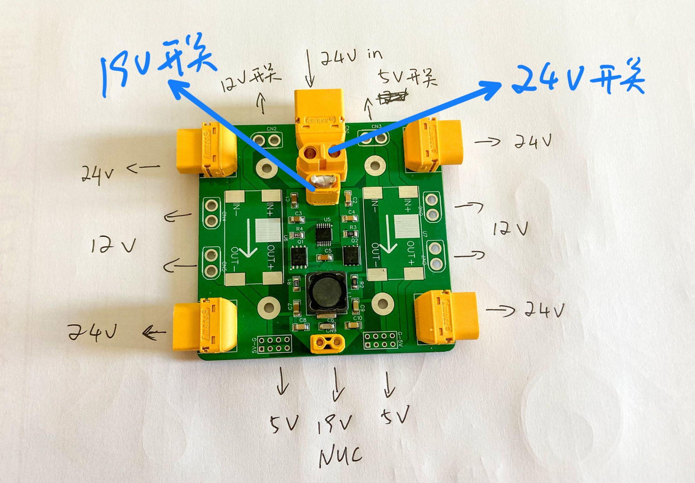

A solution based on webench powerdesign, other instructions are shown in the figure.
In order to ensure the stability of strong power supply, a six-layer board + large-area copper paving is used, and the measured stability is good.
All chip components are in 1206 package, and the maximum tolerance of related components is 10%. Please change it according to Lichuang's inventory situation.
