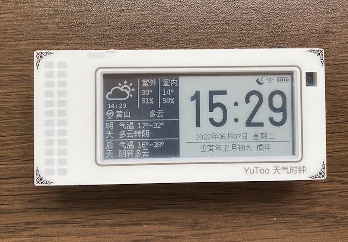

Let’s take a look at the actual photos first
# Main interface
# Time interface
# Weather interface
# Of course, e-books are indispensable, right?
# The setting interface is also very rich.

I received the 3D Monkey printing. The printing material is nylon. The price is really expensive, but the effect is much better. However, it is only black. I have also uploaded a few pictures. Take a look:
The entire project took more than a month longer than expected, mainly because some functions have not yet reached my own expectations:
1. WeChat management function, in fact, the function has been completed, but I found that the whole system will become unresponsive when WiFi and Bluetooth are turned on together. I have no choice but to give up the Bluetooth function. If it can be solved later, it will be enabled through version update;
2. The design of the casing. This is something I am really not satisfied with. Firstly, I don’t know how to do it and learned it temporarily. Secondly, it does not meet expectations. Also, the temperature is relatively high during operation. If the ink screen is attached to the PCB, it will not work. Affected by temperature, the display effect will be affected, and the cable length is also reserved, so if you have the ability, you can redesign the casing;
3. I originally wanted to add the Mesh function, but it was also affected by the system. After all, the ESP32-WROOM memory is too small and the work is very unstable;
4. Because the ports are not enough, the SD and screen reuse SPI, which causes the upload function to be abnormal. Previously, it was normal to use SDMMC driver, but this occupied too many pins, so I temporarily canceled the upload file function (later). If it is resolved, it will be enabled through updates).
