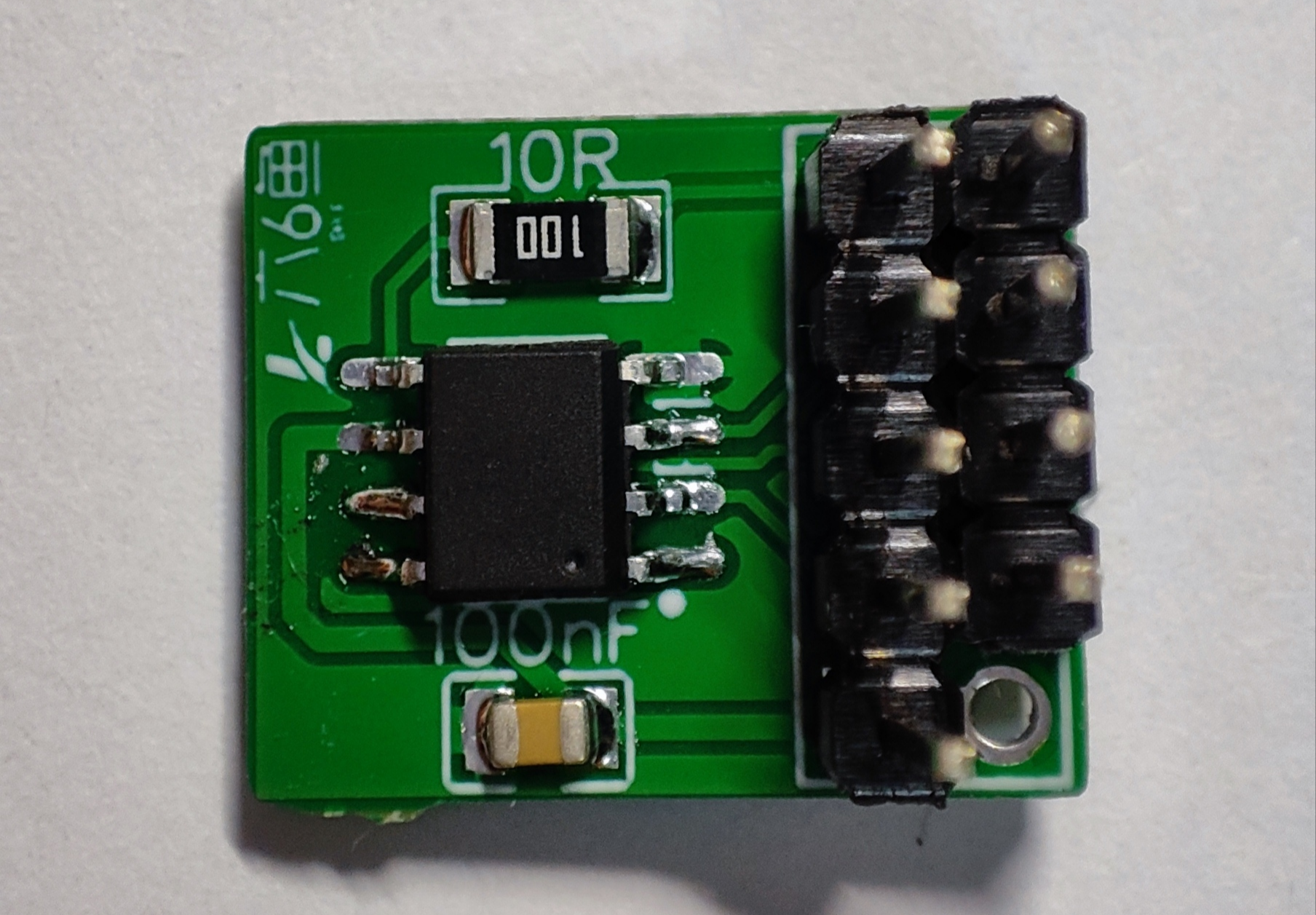

ReleaseV1-WS2812-RGB control module-lights up when powered on
The chip is programmed with approximately 120 lighting effects and can support the control of 400 WS2812-RGB lamp beads.
Working voltage: 3.2V-5V;
Three function buttons: previous lighting effect, next lighting effect, and speed adjustment.
Press the "Previous Light Effect" and "Next Light Effect" buttons at the same time to trigger the cycle of light effects. The cycle starts from the first light effect and automatically changes modes. During the cycle, press "Next Light Effect" to end the cycle. , and stay on the first lighting effect.
The speed adjustment button can adjust the changing speed, from slow to fast, with a total of 8 levels of speed. Adjust it to the fastest and then press the "speed adjustment" button to return to the slowest speed.
It has a power-off retention function. If the power is accidentally cut off during use, the current lighting effect and speed will be saved, and the last lighting effect and speed will be automatically used when starting next time.
