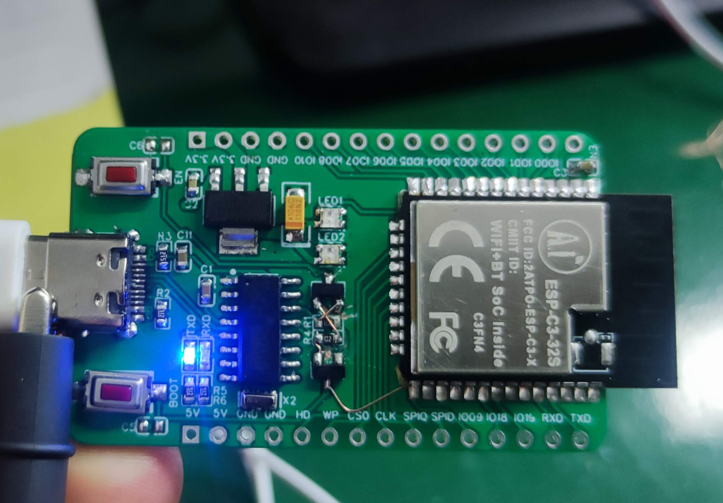

ESP32-C3-32S
 Using ESP32-C3-32S module
with two WS2812
TYPC port
Physical map
Flash MicroPython
Debugging corrected the error of the automatic download circuit and the BOOT pin is GPIO9.
