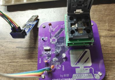

atmega328p programming adapter board
When using the arduino atmegea328p chip, you need to burn the bootload first, and then the burning program can be soldered to the application development board. Use the TQFP32 clamp to fix the chip, but some external circuits are needed during burning. This project is an intermediate circuit needed for burning. plate. Let the chip be connected to the computer through the usb asp downloader~~~~.
Note for burning: The atmega328p chip is connected to the base through the TQFP32 fixture, and then the burning base is connected to the computer through the USB ASP. Without the burning fixture, the burning board can also be soldered directly to the computer through the USB asp.
