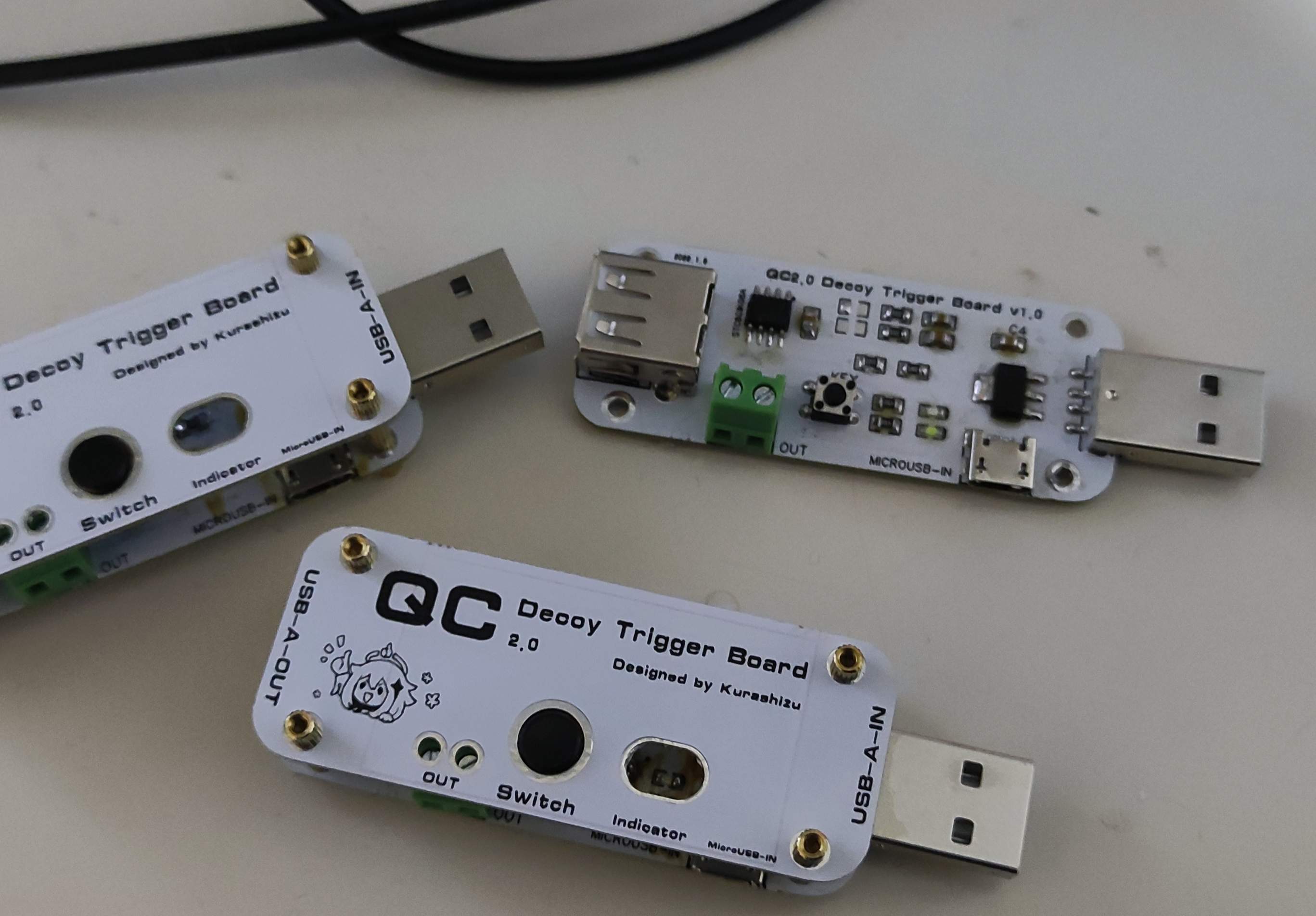

By outputting the PWM wave, it outputs a constant voltage to the USB D+D- pin after RC low-pass filtering, and monitors the voltage changes in real time through the ADC. Considering that the push-pull output of this microcontroller has a high current draw, the pull-up resistors R1 and R2 do not need to be welded (actually it was a design mistake at the beginning). See attachment for source code
