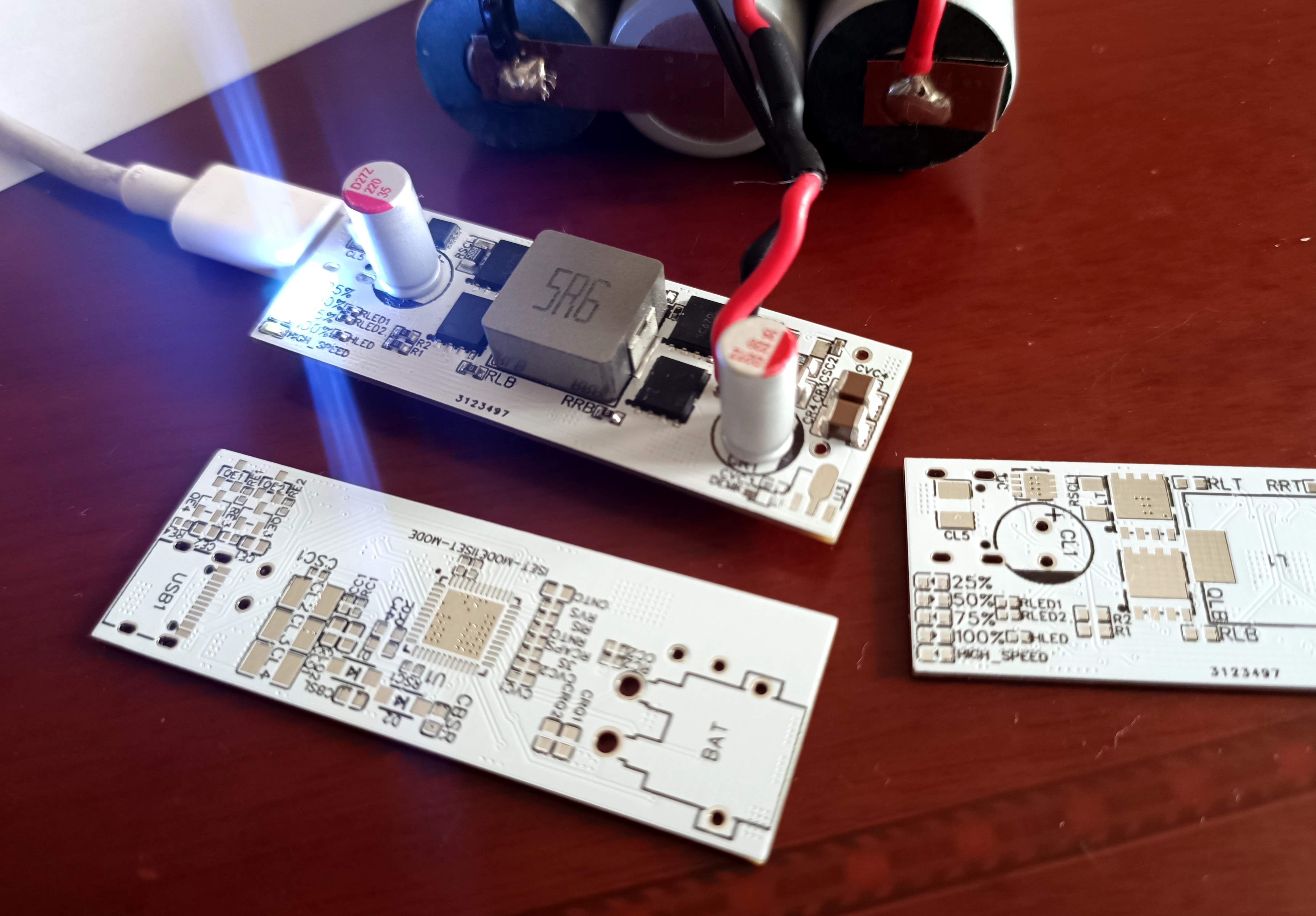

IP2368 mini version [PD100 watt 2 to 6 string lithium battery charge and discharge module]
! ! ! ! ! I discovered the cause of instability and didn’t pay attention to resetting when wiring! ! ! ! !
Lithium battery charging module designed based on Yingjixin IP2368-NACT chip
(Applicable to IP2368-NACT, IP2368-COUT)
For details, please refer to the original project IP2368 [PD100 watt 2 to 6 string lithium battery charge and discharge module]
Only 21*60mm, the same width as the 21700 lithium battery
Pay attention to heat dissipation
The EMARK circuit was not added during verification. The theory is feasible and we look forward to feedback.
The BOM has replaced some components, please pay attention to proofreading.
