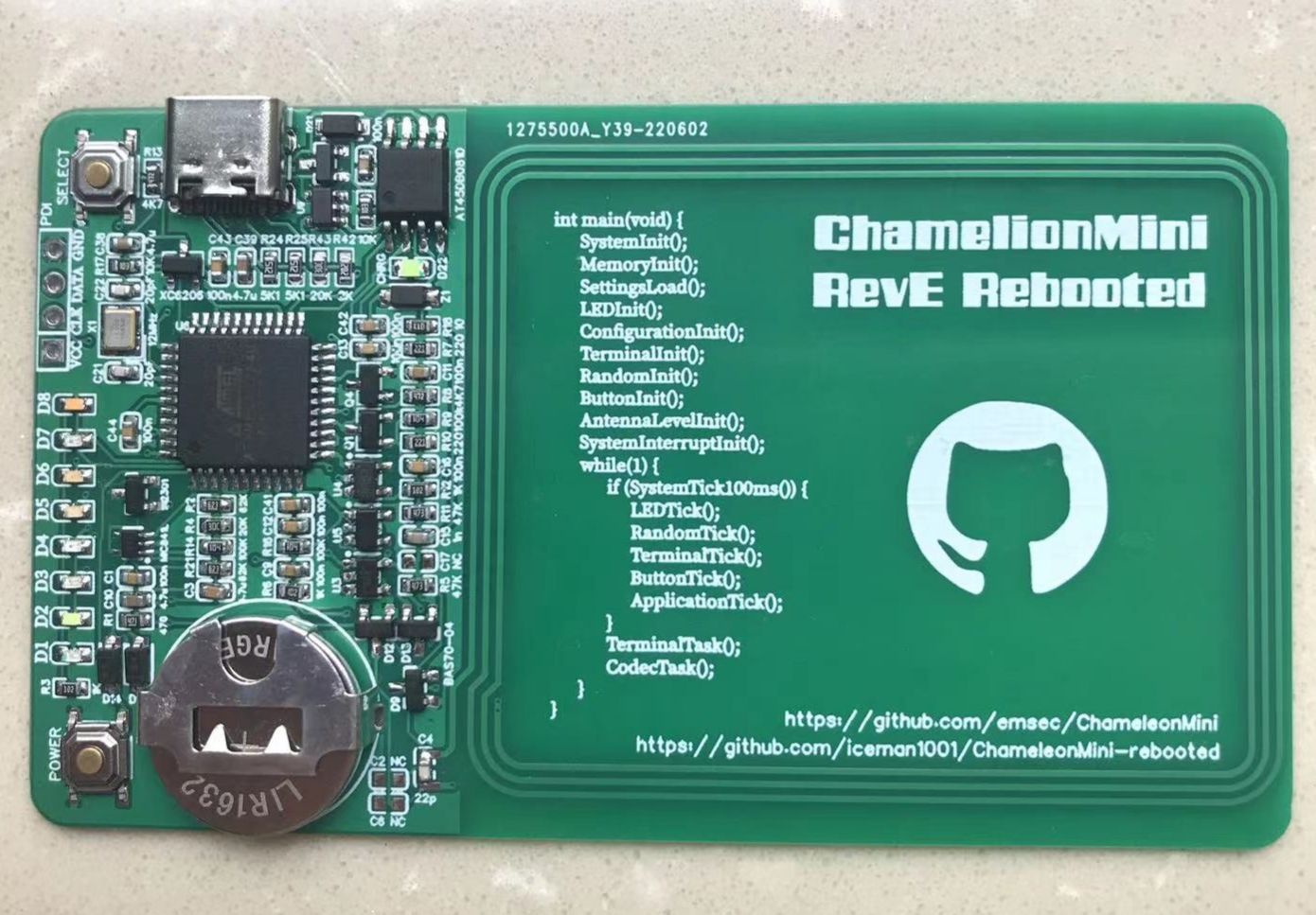

ChameleonMini is based on a piece of hardware for multi-band and multi-type RFID simulation designed by a German university when studying RFID security. Realize functions such as M1 card simulation and key sniffing.
After being open sourced, ChameleonMini branched into G version and E version. The E version was modified by the big guys and developed into ChameleonMini RevE Rebooted. This design mainly refers to the project released by iceman1001 on github. I made some modifications based on the components on hand and the actual debugging situation:
1. The components of the entire board are on one side, and the overall thickness is relatively thin (different from those on a certain product) );
2. Switch to a rechargeable lithium button battery (LIR1632) with onboard charging circuit;
3. Use the TYPEC interface (after all, I bought 100 TYPEC female sockets and couldn’t use them all);
There’s not much to say about the hardware:
In a previous experimental version, the battery used non-rechargeable CR1220, and the result was that it could not drive the chip:
Officially released version 1.0 (2022-06-07), using rechargeable lithium battery LIR1632 with charging function. Note that the two PCBs currently released are both of this version, but the pattern design of the antenna part is different:
1. Because the reference voltage of the rechargeable battery is 3.6V (more than 4V when fully charged), which exceeds the power supply voltage range of the ATXMEGA32A4U, the battery cannot be directly powered according to the official design. Changed to use LDO for both battery and USB power supply, added a switching circuit between battery and USB power supply, and added a charging circuit for the battery to realize the rechargeable function;
2. Based on the actual test, the charging resistor in the delayed shutdown circuit was modified to extend the shutdown time after the system starts;
3. Based on the actual test, the induction self-start circuit was modified and the voltage comparator voltage dividing resistor resistance was adjusted to ensure that the induction start function is effective.
