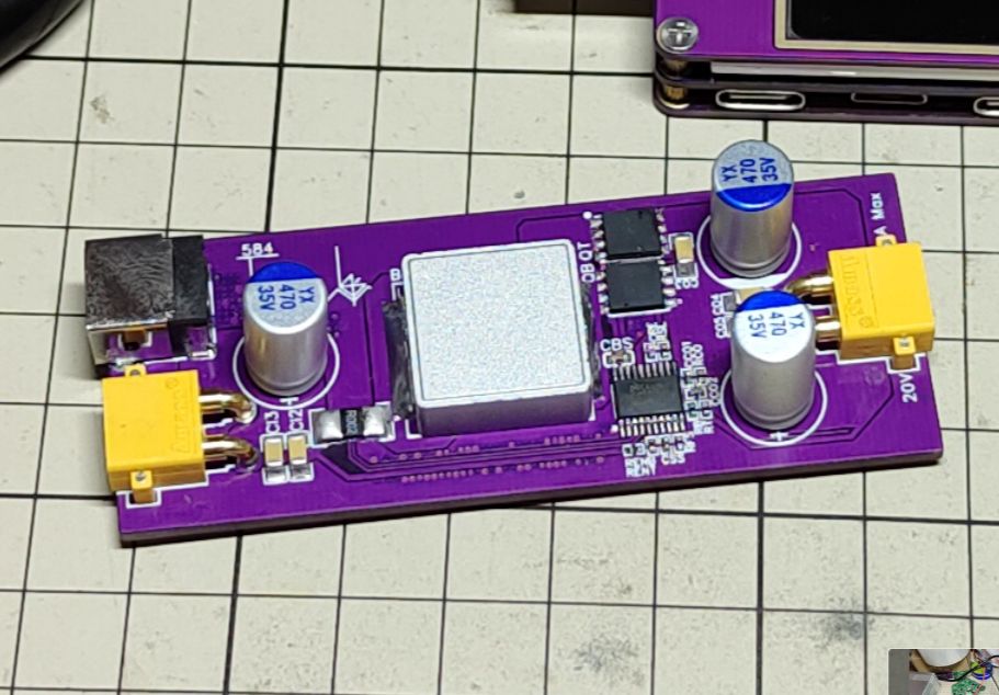

Love Tomb Style No. 584 - 200W20V Boost Module in LM5122 Atmosphere
Input side:
     Voltage:11-19V
     Equipped with XT-30+DC_044 input slot
Output:
     Voltage:20.2V
     Output current capability: maximum 10A
The current limit is on the input side. Generally speaking, the input current should not exceed 15A.
Design efficiency 96%
The inductor can be flexibly replaced according to your actual scenario. It is recommended to adjust it between 3.3-10uh.
Laoge (wzw666) tested this module and drew the PCB panel.
