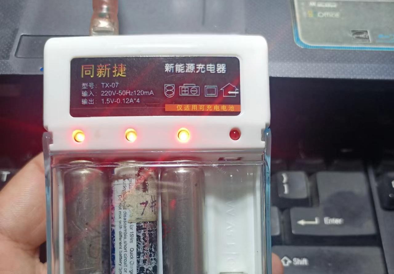

Ni-MH battery stupid charging changed to LM324 controlled full stop
Use TL431 to establish the standard voltage, and use LM324 as a comparator to control the on and off of the 8550 transistor to control whether the charging is cut off.
