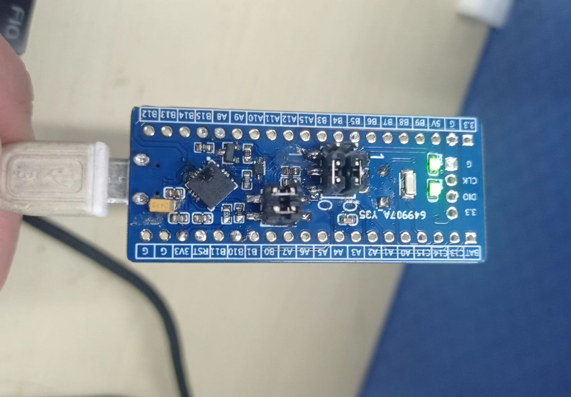

An STM32F103C8T6 core board that is pin-compatible with commercially available BluePill has added CP2102 and surrounding circuits without changing the size of the board, allowing one-click downloading.
But it was precisely because of the new circuit that the reset button was removed.
This design mainly refers to the following articles.
STM32F103C8T6 (BluePill) - Jialichuang EDA open source hardware platform (oshwhub.com)
https://oshwhub.com/583703056a/ch340c-stm32f103c8t7
I did a test of lighting up the onboard LED. The program can be downloaded with one click, but the USB needs to be plugged and unplugged to run.
