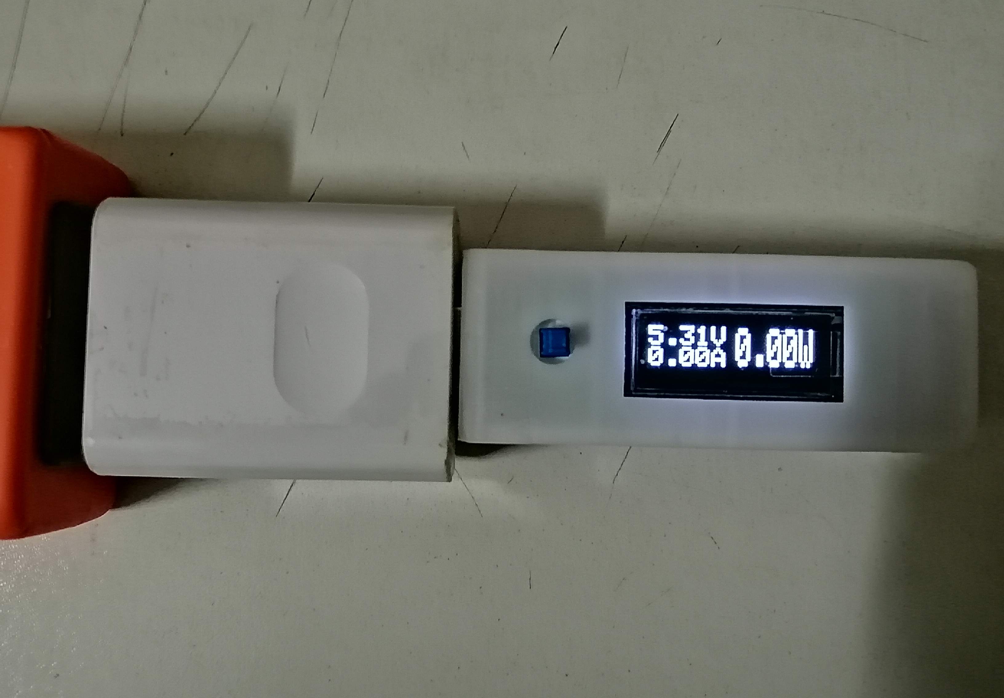

* 1. Project function introduction
Using the National Technology ARM Cortex-M4 core chip N32G430C8L7, plus the USB voltage, current, and power meter implemented by Texas Instruments INA199A1, the simple RGB colored lights are expanded.

uses LiChuang EDA professional printing. The expanded RGB colored lights, each color LED shares an IO and is driven by a transistor.

I originally planned to make a PWM gradient light, but because the MCU's IO port was not independently led out and the MCU was below the screen, it brought great inconvenience to debugging. After a long time of tossing and turning without progress, I finally changed to a relatively simpler RGB light.
After the physical object was completed, after many tests,
the voltage value displayed by the power meter OLED was 0.2V to 0.3V higher than the value measured by the multimeter when powered by a mobile phone charger, and
           the current value displayed by the OLED was basically the same as the value measured by the 200mA gear of the multimeter. In the third photo, the power meter current was 0.11A, and the multimeter measured 113mA.
The overall accuracy of the USB power meter meets personal use needs.
I participated in this training camp and got a very practical measuring tool. This training camp is really worth it! Thanks to Jiali Chuang & National Technology!
