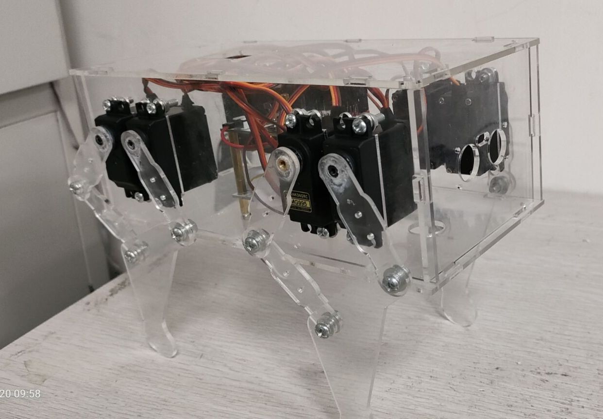

Quadruped bionic mechanical dog based on HiSilicon HI3861 module expansion
Assembly effect :
       The material of the acrylic shell looks a little out of place. I made the SW fixing hole and mounting hole a little bigger... ........... Follow-up In improving functionality and optimization.
