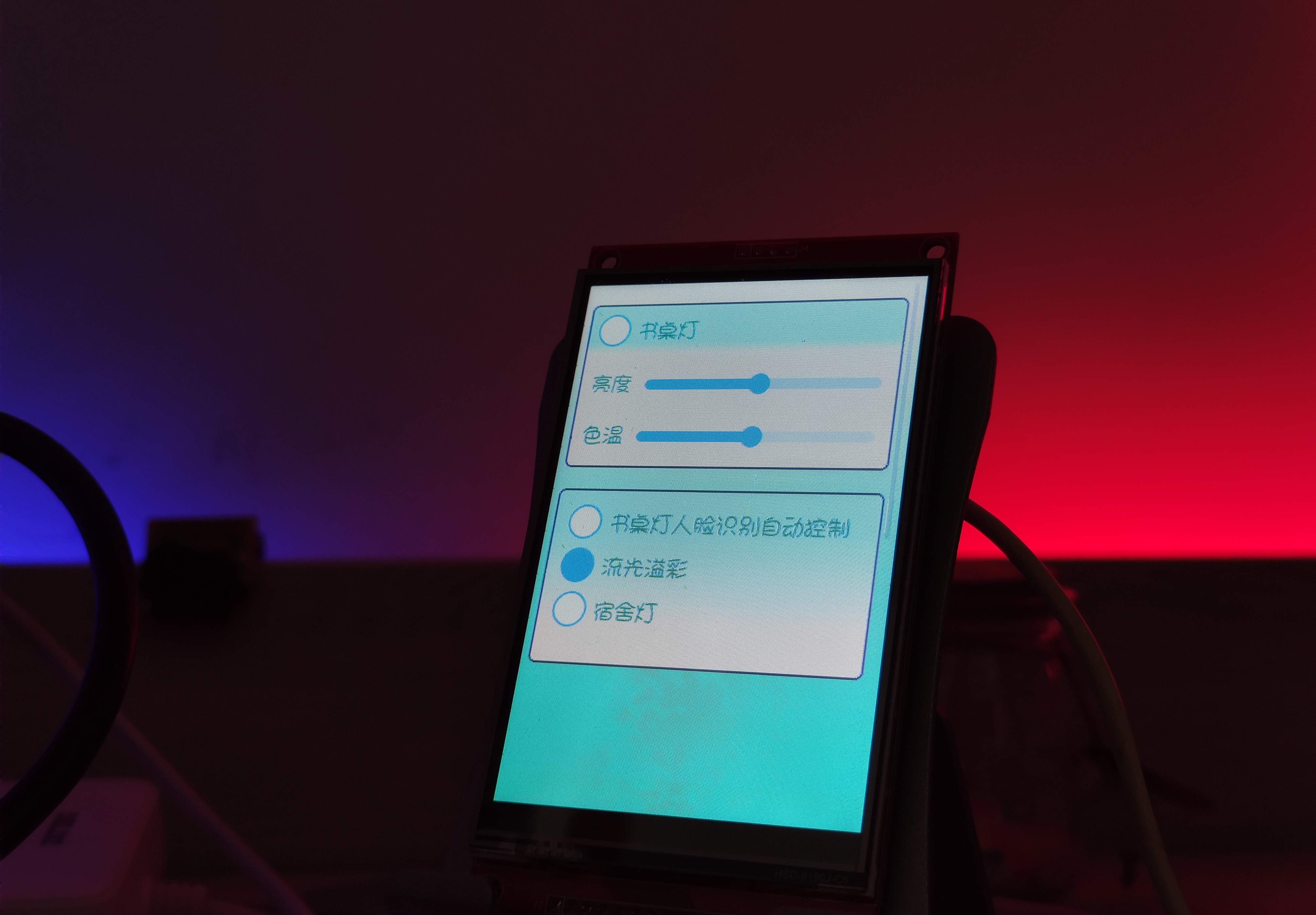

The front desk is a movable screen, which can be placed on the desktop to check the time ( NTP automatic time adjustment) and control the device. The views from all directions are as follows (the shell will be 3D printed later):
The actual overall effect is as follows (only the camera and front-end central control can be seen, and the camera will be switched to the front-end later):

②Interface:
The front-end of this system uses the LVGL open source interface library to implement the interface. Each element on each screen has 2~3 animation details, and even the background will move, making the entire interface lively and interesting. (See the demonstration or attached video for details) In addition, I designed a digital display animation library through my own method, which can achieve a smooth and interesting switching process between any two numbers from 0 to 9. In order to speed up the development, I first used the ported version of LVGL on the computer VS2017 to design and debug the interface. After the final interface was completed, I imported it to ESP32 for running and adaptation. Although the final actual frame rate is not high, it is still worth it considering the cost of the front-end main control chip is less than 15 yuan.
Some screenshots of the interface are as follows:
The actual display effect is as follows:
