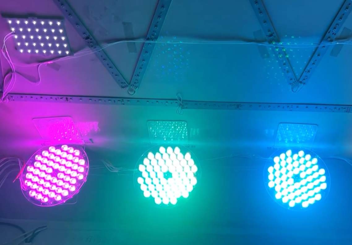

It is very common to use STM microcontroller SPI to control WS2811/2812 lights, but they generally have low power and low brightness, and are not suitable for other high-power equipment such as stage lights or light strips.
This is a control card that uses the WS2811 SPI bus to control high-power devices. There are 12 output channels in total, and the theoretical current of a single channel can reach 15A (not recommended).
Use high power mos and some logic chips. Convert the output of WS2811 into PWM signal and input it to mos for control.

Effect video:
https://www.bilibili.com/video/BV1E3411j72q
