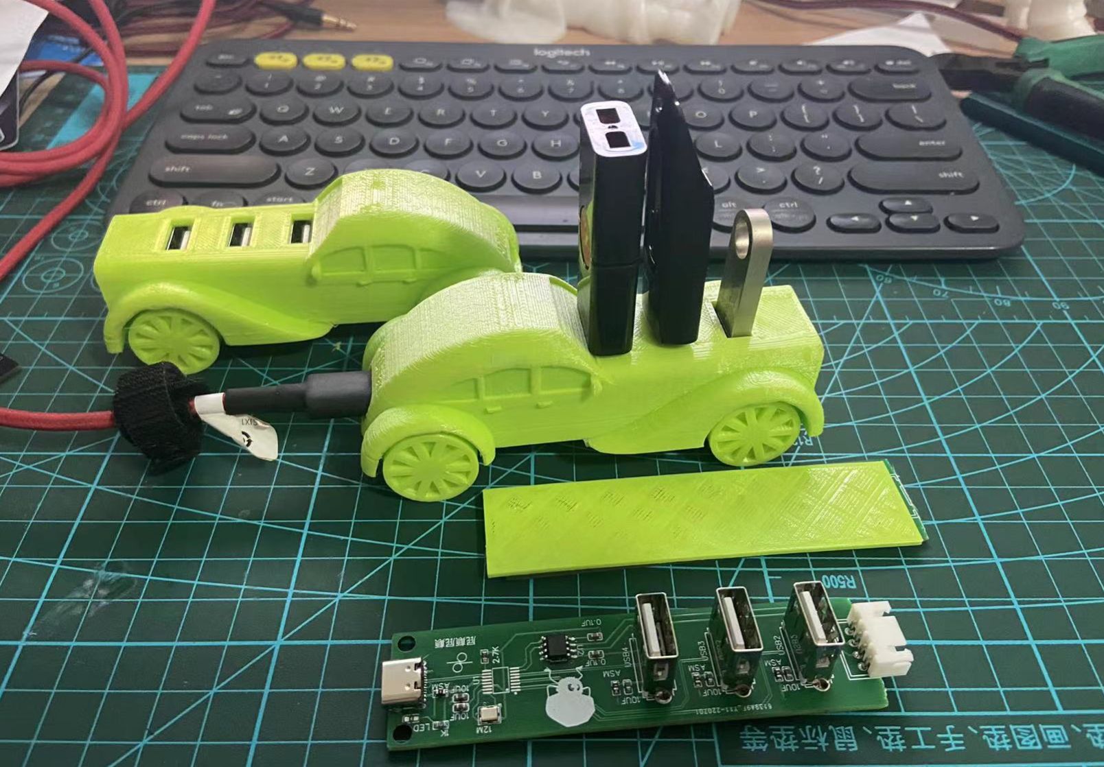

usbhub adopts fe8.1+CH340N solution, 1 minute 4 (3 USB + 1 USB to ttl) simply draw a shell and 3D print it
( Note that ASM is a self-restoring fuse ASMD0603-050. I was too lazy to replace it with a resistor when drawing the picture )
