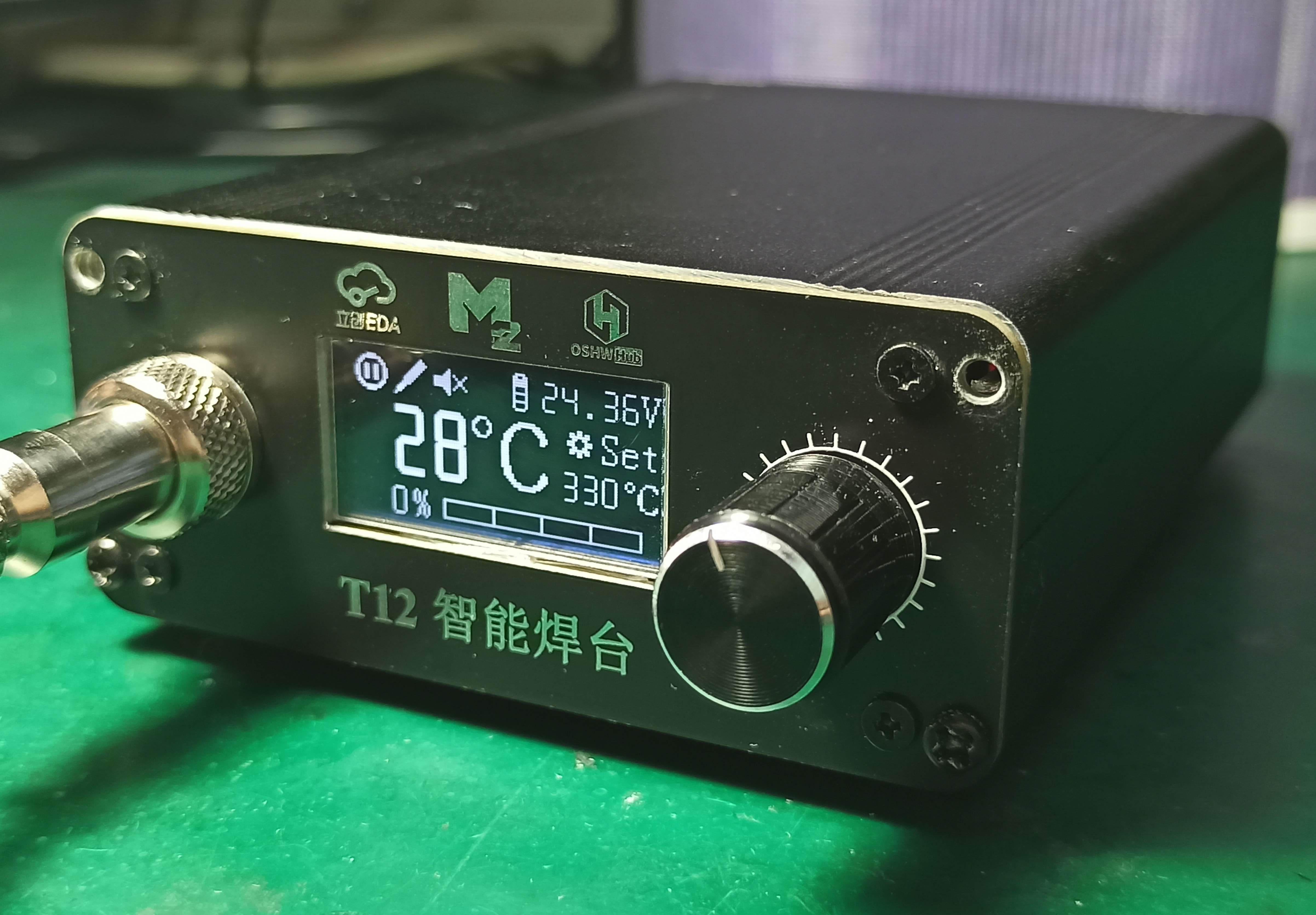

    This project is a reset and upgraded version of the T12 intelligent constant temperature soldering station. It uses an 8838 aluminum alloy shell, integrated power supply and main control, a new interface UI, and a buzzer and OLED display transition animation.
    The BOM list and program are in the attachments, and the BOM list in the attachment shall prevail.
    SW1.1 is the menu with vertical lines, SW1.2 is without vertical lines, and the one with 0.96 suffix is ​​the firmware for the 7-line 0.96-inch screen. You can choose according to your needs.
    Over time, the programs, including cubemx project files and keil5 project, should be open sourced. 2022.6.7
   I don’t have time to write comments, so I packaged the code and attached it directly ( T12-F401CBU6.rar ). If you have any questions about the code, you can send a private message or leave a message, and I will reply as soon as possible. The code is stinky and long, please be gentle. 2022.6.26
   The open source code is for everyone to learn and progress together. Please abide by the open source agreement and do not use it for profit.
    The production process is similar to the previous version. Note that D1 and power input interface U4 have not been welded. When welding the OLED screen, first fix it with M3*5 double-pass copper pillars and M3*4 screws before welding. GX12-5 and the rotary encoder Don’t solder first, and solder the others directly; after soldering the burning program, I reserved the SW download port and serial download port this time. The SW download port is connected with one of ST-Link, DAP-Link, and J-Link. You can directly download the cable. For serial port downloading, you need to short-circuit the BOOT0 pad on the PCB first, use a USB to TTL downloader to connect the wires, and then use the serial port download software to burn the program. After burning the program, remove the short-contact point. ; After the OLED displays normally, continue to the next step. If it is not normal, check the welding. If there is a 33mm × 17.5mm acrylic plate, tear off the film and buckle it to the corresponding slot on the front panel and fix it with glue. If not, skip this step. ; Fix the GX12-5 male socket on the front panel. Note that the protrusion in the socket is at the bottom this time . Insert the rotary encoder on the main control PCB, and then use M3*9 double-pass copper posts and M3*6 screws to secure it. The main control PCB and the front panel are connected and fixed, and then the pads of the two are welded; the AC-DC power module is put into the casing ; the AC power socket is buckled into the rear panel ( PCB thickness 1.6mm, socket gap 2mm, will become loose, and can be fixed with hot melt glue after alignment is correct ). Weld one end of the extra soft silicone wire to the corresponding pin of the socket, and the other end to the corresponding pad of the AC-DC power module. Weld one end of the extra soft silicone wire to The corresponding pins of the main control PCB are soldered to the corresponding pads of the AC-DC power module. The grounding end of the shell is directly connected from the AC power socket to the main control PCB. Assemble the entire shell to get the finished cover. (Please refer to the previous version for handle production)
