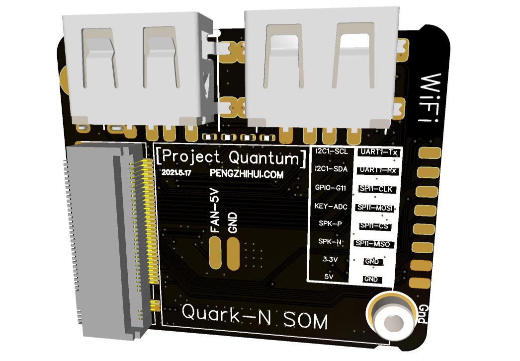

Manually imported the Quark N baseboard of Zhihui Jun's Project Quantum project into Lichuang EDA.
Manual work is as follows:
  • Matched the pads to the schematic
  • Rematch schematic to PCB
  • Eliminate flying line errors
  • Slightly modified design rules and copper laying rules
  • Because the copper laying effect is different, some GND vias are added
  • Adjusted silk screen font and position
Precautions:
  • It has not been tested in actual samples yet.
  • It can pass the DRC check, but the design rules are not perfect. Sometimes there are overlapping errors, but there are actually gaps.
  • Every time after synchronizing the PCB from the schematic, there will be some wire network numbers twitching (basically the teardrops of the AD import file), but the number of twitching is very small and can be eliminated manually
