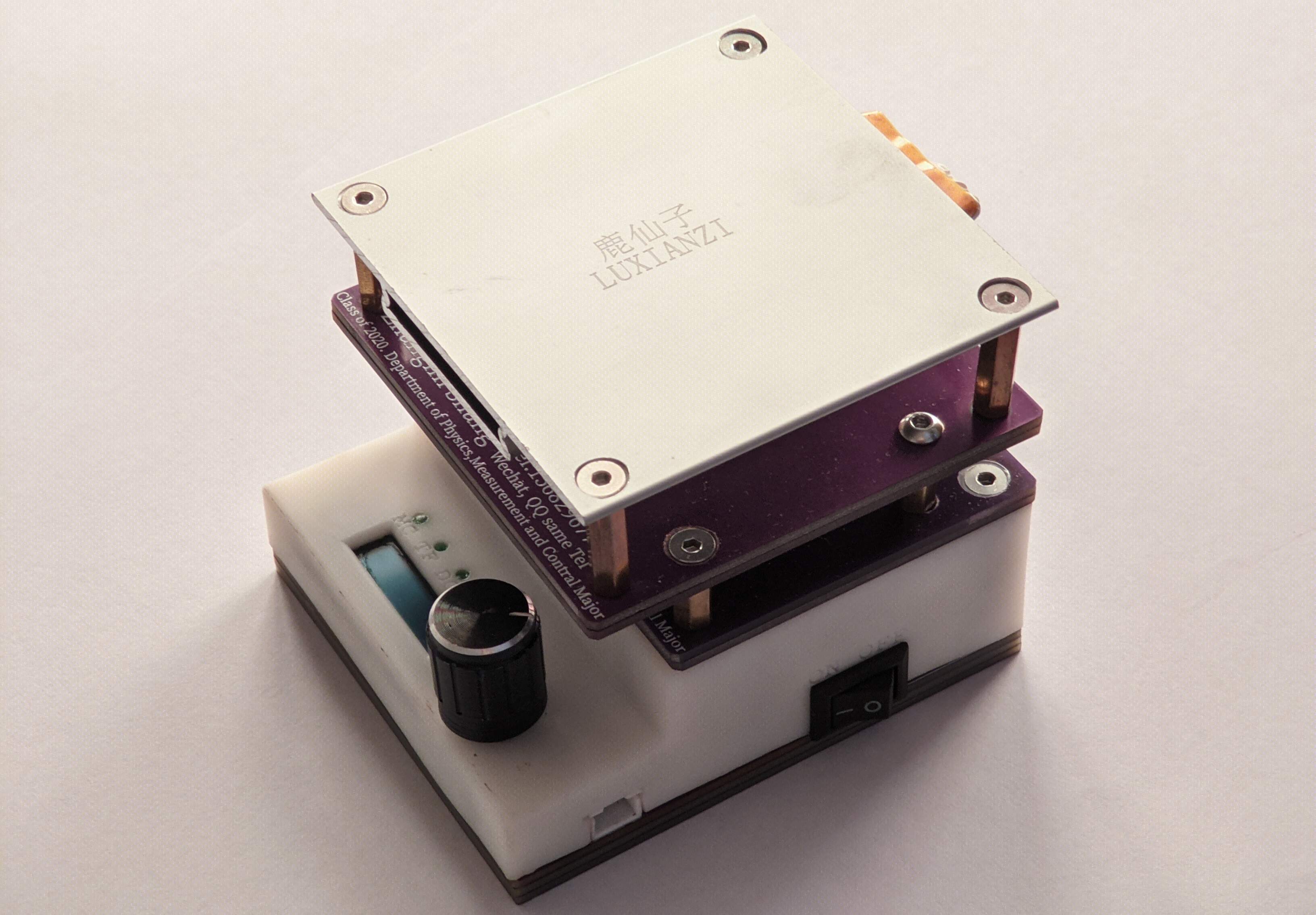

Reproduction of Qifan Science and Technology Internet of Things Hot Station
Qifanke’s original firmware and schematics can be found on the hardware open source platform https://oshwhub.com/dhx233/pcb-heng-wen-jia-re-tai
Modification content:
       Changed the original fan interface to horizontal installation
       The screen is connected with wires and fixed to the 3D printed housing.
       All LEDs in the project are connected to the housing with flying wires
       Redraw the 3D shell to make it more beautiful and Elegant
       Repaint the pcb partition to be more Graceful
       The bottom fence was changed to PCB material, and the Irena label was added
Other consumables:
        Countersunk head M3*8 hexagon socket screws 20 pieces
        6 countersunk head M3*5 hexagon socket screws (cross-shaped ones are also acceptable)
        Earth-shaped copper nut eight-shaped twill hot-melt inlay: M3*10*5 4 pieces
        Single-pass hexagonal copper pillar: M3*10+6 2 pieces
        Double-pass hexagonal copper pillar: M3*10 2 pieces
                                 M3*18 4 pieces
                                 M3*25 4 pieces
        The thermistor specifications are resistance value 100kΩ ±1%B value 3950 glass seal. Attached tb link: https://m.tb.cn/h.fyFlxZv
        2mm tower-shaped light-emitting diodes 3 pieces
        XH2.54 2P male terminal 2 pcs
        XH2.54 6P male and female terminal kit 1 pair
        To-220 packaged single tube needleless small aluminum heat sink (see 3D preview)
        to-220 packaged insulating pads and insulating particles
        Deer fairy heating plate 68*70
        High temperature resistant silicone white latex is used to fix the ntc temperature probe in the heating plate. Kraft 704-N thick white sealant is recommended.
        502 glue
        Silicone braided high temperature resistant wire 20cm
The redrawn 3D shell has been stored in Baidu Cloud
        Link: https://pan.baidu.com/s/1wu7SMwtqXKGyTk5QajP4ZQ?pwd=ShZl
        Extraction code: ShZl
Since the project involves the use of mains power, we are not responsible for any electric shock accidents during debugging and use. Once you adopt this open source project, you will accept and bear the risks!
