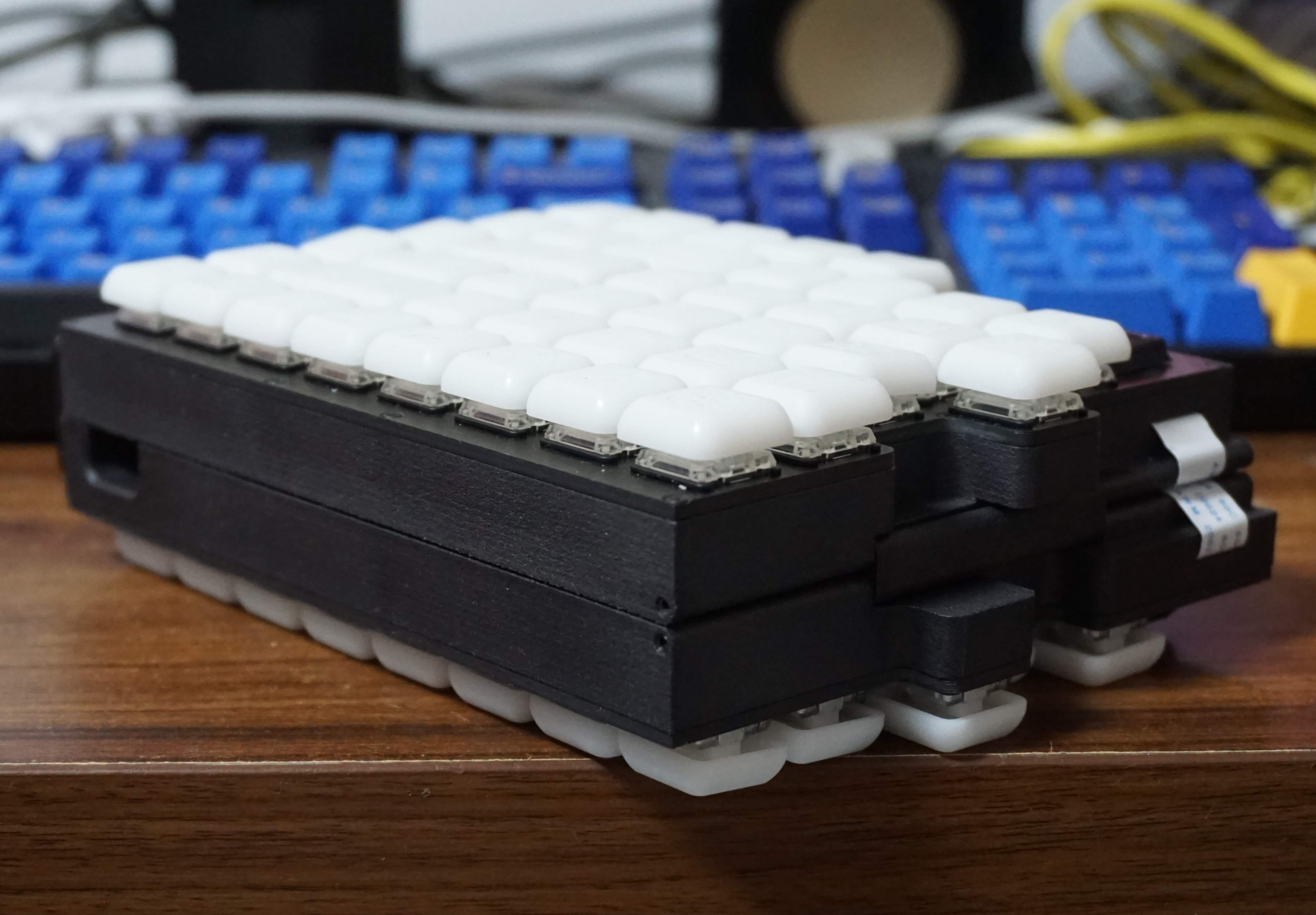

I am a travel enthusiast and also have a strong need for customized buttons for e-sports and multimedia, so I conceived this modular portable keyboard with USB hub and an OLED screen.
The main control uses at90usb1286. It has a huge programmable space (128 kB) and a lot of IO ports. This is the reason why I chose him. The only drawback is that the price is slightly higher, 75 yuan on Taobao. Kaihua choc axis body.
The data transmission is completed by the cable, which is quite reliable (I didn't buy one with the right length, and it has grown a little now, but it doesn't affect it)
Folding is a simple matter of using two optical axes (2mm diameter, zero-cut, 100mm, Taobao, 10 yuan, free shipping), and the twisting is very smooth. It looks pretty nice to put a few meters of screws on both sides of the optical axis (I think it looks nice)
Many people complained about this controller. I happen to have two pieces in stock on hand, and the price is indeed high. In fact, if you really like it, you can change the main controller and go offline again. The source code I gave you can be migrated to many high-quality and low-priced main controllers.
A better idea is to replace the cable connecting the two motherboards with a spring shock (Xiaomi bracelet charging port) and then use two main controllers for IIC communication, which is better. The problem is that there is not enough flash capacity to play with the firmware.
The thickness is also compromised by the USB port. Removing the USB port and re-drawing a shell can reduce the thickness to one-half or even one-third of the current thickness. However, I really need a convenient interface for transferring ppt and other things.

In addition, if it is folded and placed in a backpack, foreign objects may enter the USB port and cause a short circuit (my bag is a huge mess, and there are often inexplicable small parts, and I have to clean it every time I come back), so I made a dust cover.
The dust cover also has another function - to raise the bracket (all magnets are attached, the magnets are very cheap, and the white ones are the extra cables)
The height of the pad is also in line with my personal habits.
The data cable is separated from the C port key cable. I made additional sinking. I think it looks good.
