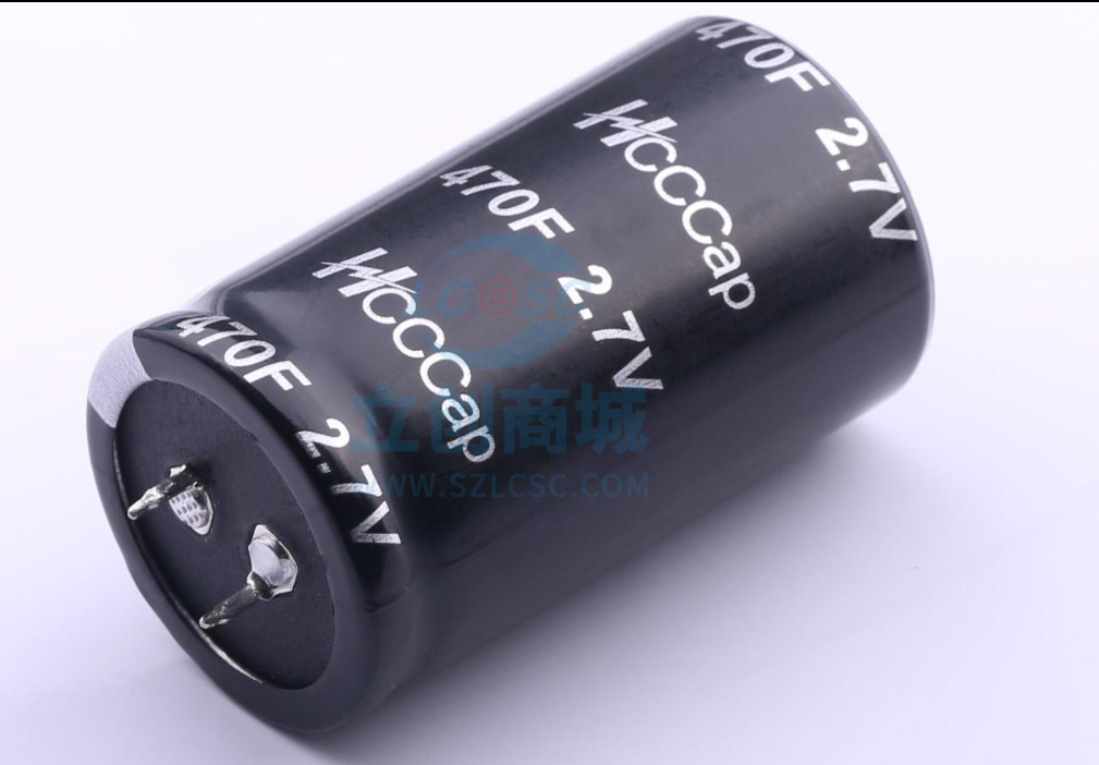

Supercapacitor charge and discharge protection board
Use LM317 to provide a constant current charging source for the capacitor, and use a protection board to protect the capacitor from being overcharged. Suitable for 2.7V Farad capacitors. At the same time, the current is adjustable (by adjusting the resistance value of the resistor) to achieve protective charging. Compatible with 5V USB and 12VDC input, supports up to 2A
