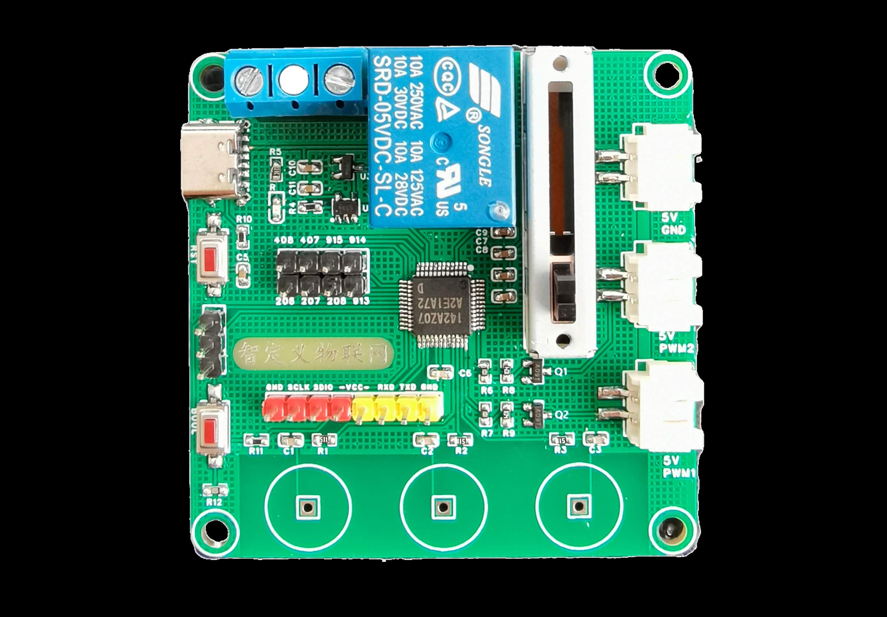

Project configuration:
Main control chip: R7FA2E1A72DFL32
Power supply: typeC+2.54 terminal block
Control: 3 touch buttons + reset + download + relay + 2 PWM outputs
DAC adjustment: 10K adjustable resistor
Debugging: serial port debugging + JLink debugging
Lead out: 8 GPIOs
The main control light panel uses an aluminum substrate with better fan heat, which can quickly fan heat, reduce the temperature of the lamp beads, and extend the life.

Project summary:
1. The voltage of the plant lamp is ignored. The 5V power supply is not bright enough.
2. This plant lamp is difficult to solder. It is recommended to choose Jialichuang SMT.
