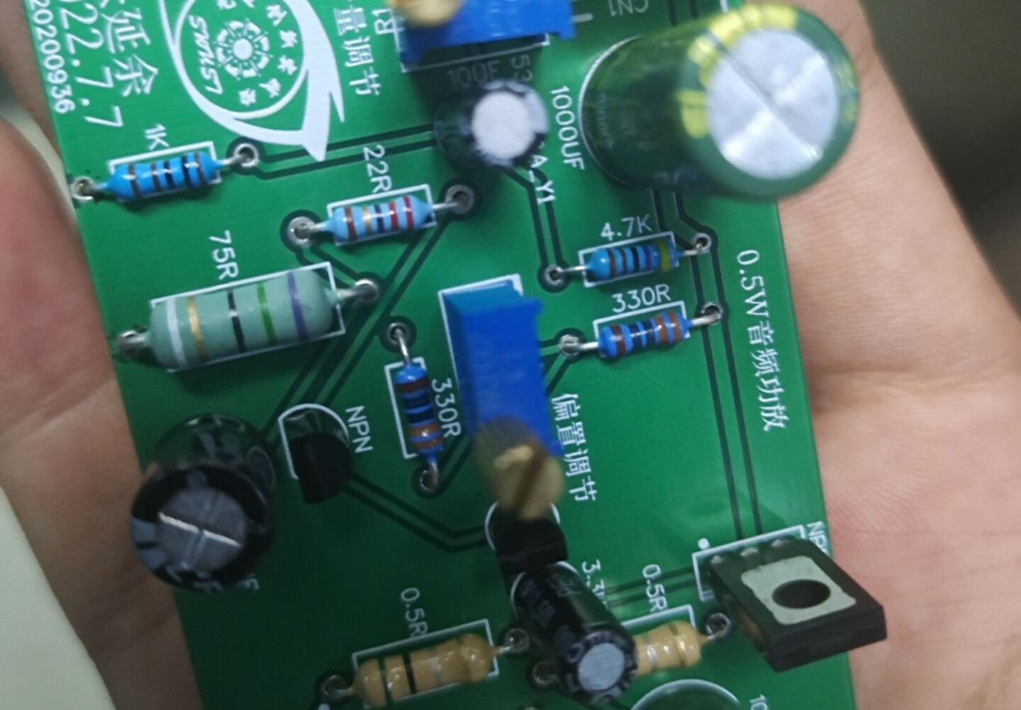

15V schematic
Use NPN and PNP power tubes for push-pull output, and use transistors for first-level amplification. The input signal voltage is 0.2V, the output is 0.5W, and the volume is adjustable.
