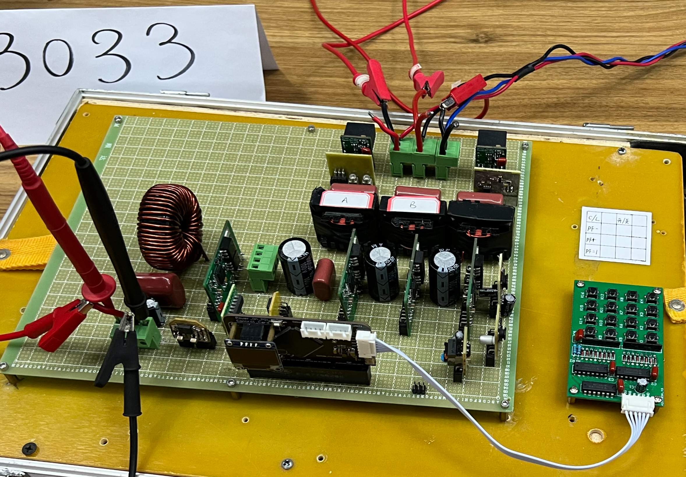

## 4. Abstract
This system consists of a three-phase PWM rectifier circuit, a Buck voltage reduction circuit, a measurement circuit, a control circuit, and an auxiliary power supply. The system uses STM32F407ZGT6 as the main controller, calculates the grid voltage phase through a phase-locked loop, and directly controls the amplitude and phase of the rectifier input current under dq coordinates. The rectifier outputs a 50V DC bus voltage, and after passing through the Buck step-down circuit, it outputs a stable DC voltage of 36V. Under rated operating conditions, the system input power factor is not less than 0.998, and can be set arbitrarily within the range of 0.90~1.00, with a step value of 0.01; the output DC voltage is stable, and the load adjustment rate and voltage adjustment rate are both less than 0.05%, and The overall efficiency of the machine can reach 96.2%. In addition, the system also has over-voltage and over-current protection functions and a good human-computer interaction interface.

This system is a three-phase AC-DC conversion circuit. The system consists of a two-stage converter. The front stage uses PWM rectifier topology to achieve AC-DC conversion; the rear stage uses Buck topology to stabilize the DC output voltage. The system uses STM32F407ZGT6 as the main controller. When the system works under rated operating conditions, the overall efficiency is 96.2%, the input side power factor is 0.998, and the power factor is adjustable within the range of 0.90-1.00, with an error of less than 0.02. In addition, the load regulation rate and voltage regulation rate of the system are both less than 0.05%. At the same time, the system also has over-current and over-voltage protection functions and a good human-computer interaction interface.
