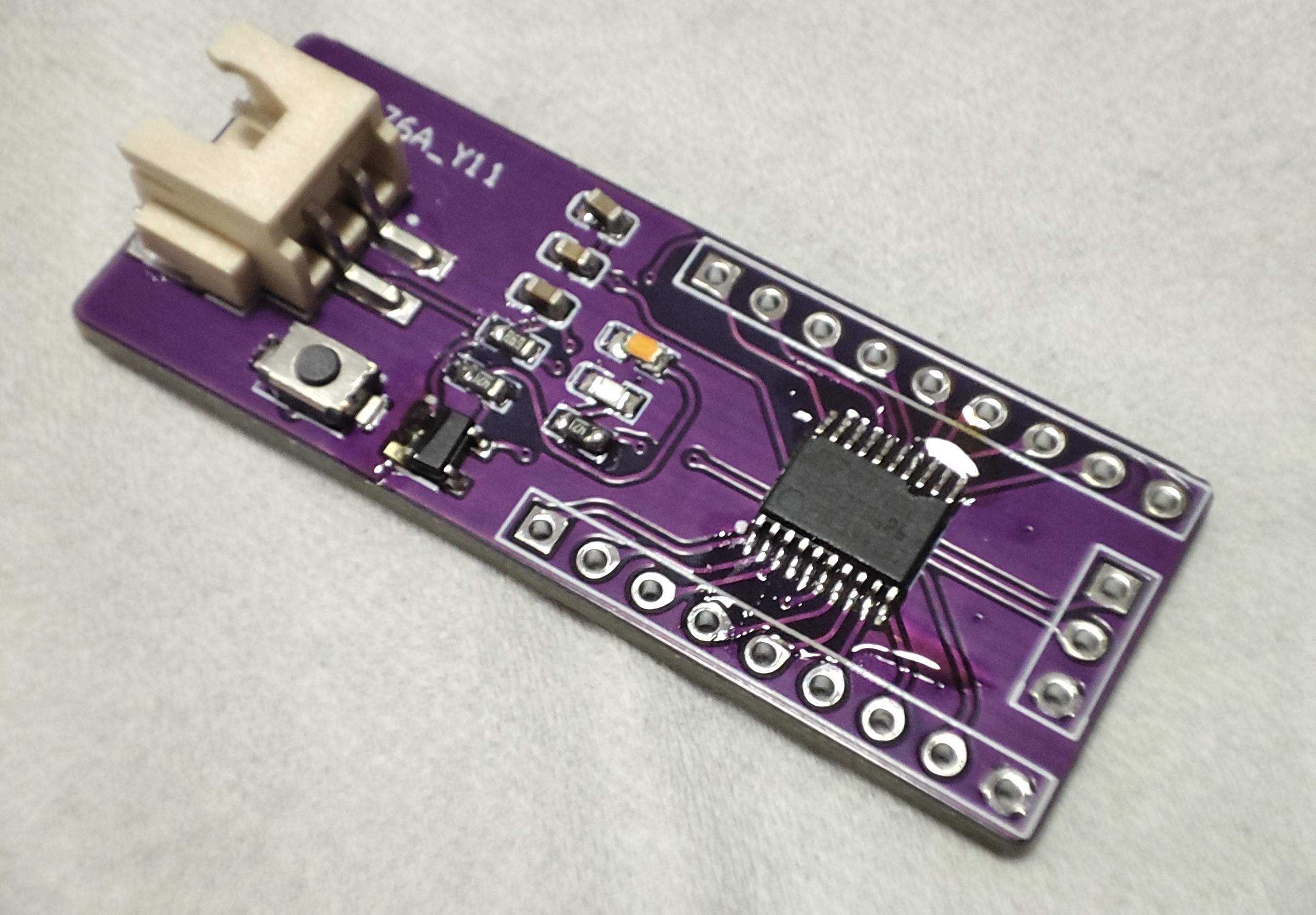

stm32g030f6p6 development board
Mini development board based on stm32g030f6p6 (verified)
rev0:
Use XH2.54 horizontal sticker instead of USB power supply.
The swd debugging interface at the end does not lead to 3V3.
Use PC15 (external crystal oscillator interface) as the LED output interface, if you need to use an external low-speed clock Please change the schematic.
rev1:
Added silkscreen at the bottom to
transplant zephyr to the board successfully, please click here for details
