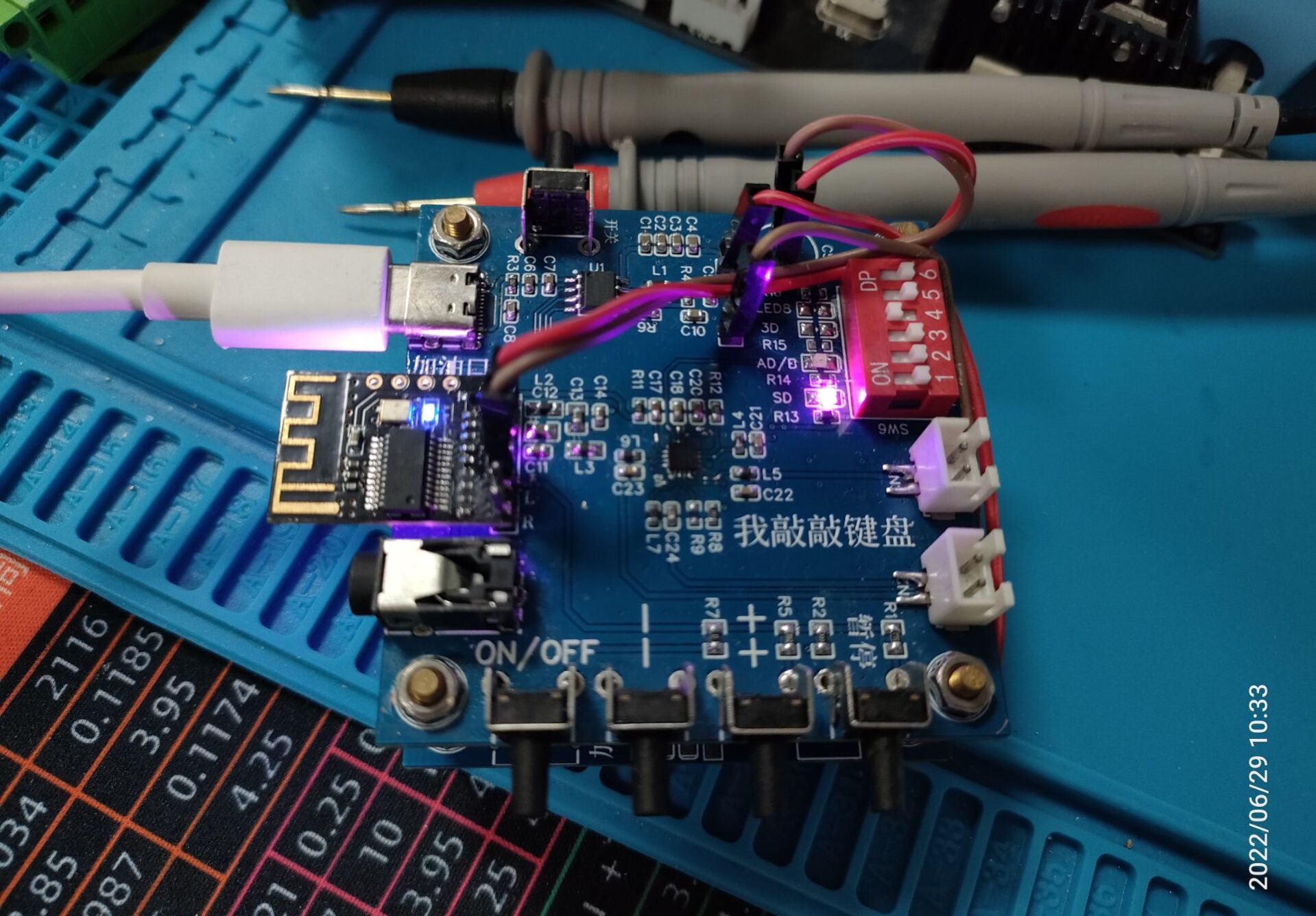

Bluetooth power amplifier audio based on NS4251AB/D class power amplifier chip expansion
Battery management part:
       A multi-functional power management SOC using IP5306 voltage-to-voltage conversion, lithium battery charging management, and battery power indication. The conversion efficiency is as high as 92%. It can be expanded according to the simplified application provided in the data sheet. It can be powered by common Micro-B female sockets and type interfaces, or it can be powered by lithium batteries, making it easy to carry. The battery input range is 3.7V-4.2V.
      Update log: 2022/6/29, add dialing code The switch seat, battery rest base, and Bluetooth part seat can be facing inward, and you can see the LED covered by Bluetooth.
LV9sdQSToz31i8hOn9BRT8SmUnrhWIjRFukvjA6N.pngBluetooth module and audio input part:
   using MH-M18 Bluetooth The module supports the latest Bluetooth 4.2 transmission and two-channel stereo lossless playback. After the module is connected to Bluetooth, Bluetooth wireless transmission can be quickly realized, which is very convenient. In an open environment, the Bluetooth connection distance can reach 20 meters.
Bluetooth V4.2 version, supports Bluetooth automatic reconnection technology, supports WAV/WMA/FLAC/APE/MP3 lossless decoding, and stereo two-channel output.
After the module is powered on, the mobile phone searches for the Bluetooth name MH-M18/MH-M28/MH-M38, and music can be played after connecting to Bluetooth;
module blue indicator light:
when Bluetooth is not connected, the indicator light flashes quickly;
Bluetooth is connected When Bluetooth is playing, the indicator light is always on;
when Bluetooth is playing, the indicator light flashes slowly.
Pin diagram:
6YYjdENSJFT5gA2nQ5xjJsVvIucEd5DKZBSFRA9B.pngMain control part:
       Add a few capacitors to the audio input and Bluetooth input to filter interference to make the sound quality cleaner.
What you need to pay attention to are the several working modes of the main control chip:
wk71JVKus7IIb25sntD4cGlW2CLJMoWWAok95Kmc.pngStatus indicator light part:
       You can switch the working mode by referring to the data manual, and read the data manual carefully.
